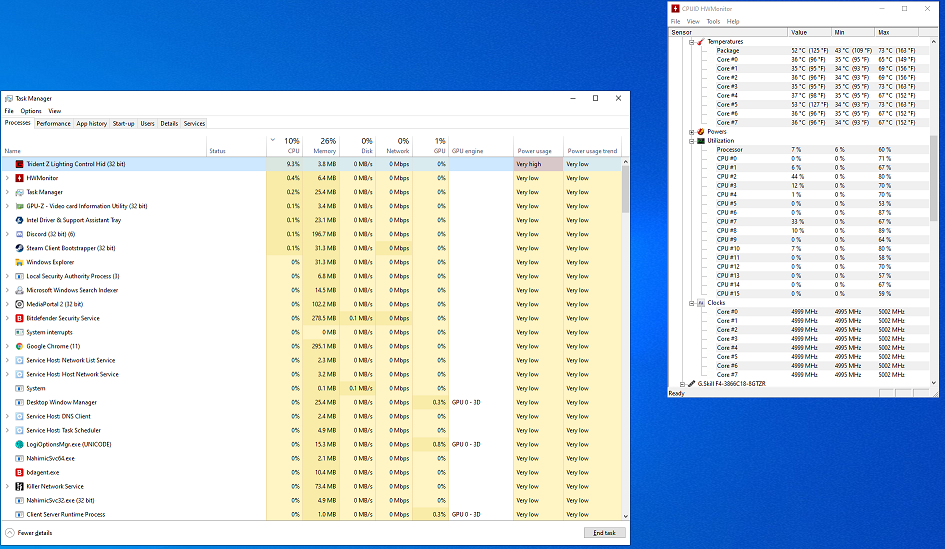

                • I'm having the "high CPU usage" issue with TridentZ Lighting Control - it forces max turbo clocks (see image) and stays there until I close TZLC.

                  There are no other lighting control app's or other RGB software installed or have been installed previously, so nothing obvious conflicting (no Dragon Centre/Mystic Light for example).
                  I've even followed the clean uninstall procedure for TZLC and reinstalled, but the issue remains.
                  Hardware:
                  - MSI MEG Z390 ACE BIOS MS-7B12v17 (1.70)
                  - Intel Core i9 9900K
                  - TridentZ RGB F4-3866C18Q-32GTZR
                  - Palit GameRock 1080
                  - Samsung 970 EVO Plus 250GB NVMe M.2 boot drive + 970 EVO Plus 1TB NVMe M.2 and a few other storage SSD's
                  - Seasonic 850 FX
                  OS - Windows 10 Pro Version 10.0.19041 Build 19041 (2004)
                  All other RGB hardware (fans etc.) is connected to separate hardware controllers. No motherboard or software interaction.
                  The RGB of the RAM when no software is installed goes out of sync very quickly and looks yukky next to the rest.
                  Any help and advice appreciated.
                  Many thanks.
                  Kind regards,
                  Texy

                      Can you post the settings for the lighting effect you've set? Best if screenshot of the software can be provided.

                        Thanks for the response.
                        I have solved the issue since posting but did not realise it until you requested the screenshot - I had not tried reinstalling TZLC since I posted about the issue.
                        But when I installed TZLC again just now to provide the screenshot, the issue is gone!
                        Here is what changed / fixed the issue:
                        Realtek drivers for on-board audio force installed Nahimic 3 for audio effects and control - I HATE Nahimic because it's unnecessary and bloaty - but there is no way to opt out of installing it with recent Realtek drivers.
                        So, I found an old discrete PCI-E sound card, uninstalled all realtek and Nahimic software, disabled on-board audio and installed the discrete sound card.
                        VoilĂ ! The issue is gone!
                        This adds fuel to my hate of Nahimic.
                        For information and because you requested it, here is a screenshot of the effect set - but CPU usage was high with all effects.
                        Kind regards,
                        Texy

                          Thanks for the screenshot, and we're glad you fixed the issue. We haven't been able to pinpoint any sources for causing any kind of high CPU usage, but it's very helpful with this piece of information regarding the Nahimic driver/software, we'll have our team test it out and look into it.

                              Much appreciated. Actually, that would help if you still have those. It'd help us get started.
                              - Driver name (or which specific product model the driver is for. sometimes motherboard vendors might switch between multiple audio chip solutions on a single motherboard model, so it would help us if there's a specific model number for the audio chip)
                              - Where was the driver downloaded from (e.g. Windows Update, motherboard website, or original vendor website)
                              - Driver version (for both realtek and nahimic drivers).
                              • Originally posted by G.SKILL View Post
                                Driver name (or product model) - ALC 1220 Codec with ESS Audio DAC - I'm not sure this is what you're looking for. Let me know if it's not.
                                Driver downloaded (as a package) from MSI website motherboard specific support page - https://www.msi.com/Motherboard/supp...ver&Win10%2064
                                Realtek driver version (includes Nahimic APO driver) - 6.0.8975.1
                                Nahimic Mirroring Device - 8.51.48.758
                                A-Volute Nh3 Audio Effects Component driver version - 1.8.2.0
                                Realtek Audio Effects Component - 11.0.6000.787
                                Realtek Audio Universal Service - 1.0.0.268
                                Realtek Hardware Support Application - 11.0.6000.222
                                Realtek Audio Control (from Microsoft Store) - 1.14.222.0
                                Nahimic UI (from Microsoft Store) - 1.4.9
                                NEW information to further diagnose and replicate the issue:
                                - with nothing connected to any audio output the issue does not appear.
                                - with headphones/speakers plugged into the main audio output port (Front Channel) on the rear I/O panel of the motherboard OR plugged into the secondary output port (Headphones) on the front I/O panel of the case, a reboot/restart will raise the issue.
                                - with headphones/speakers plugged into the REAR I/O panel, closing TZLC (right-click TZLC tray icon and Exit) and then performing a reboot/restart (TZLC still starting with windows), causes the issue to NOT appear. Subsequent reboots/restarts WITHOUT closing TZLC cause the issue to appear.
                                - with headphones/speakers plugged into the FRONT I/O panel of the case, closing TZLC and then performing a reboot/restart (TZLC still starting with windows), the issue still appears.
                                Unplugging headphones/speakers from the main audio output port on the REAR I/O panel causes the issue to appear.
                                Connecting headphones/speakers to an alternate source output (discrete sound card in this case) causes the issue to appear.
                                Connecting headphones/speakers to the headphone port of the display (NVidia HD Audio) does NOT cause the issue to appear.
                                It seems like the Auto-Detect Audio Output (port detection?) may be a factor somehow.
                                Hope this helps.
                                If you need anything further, please ask
                                Kind regards,
                                Texy
                                [EDIT to add more information]
                                To provide the above information, I re-enabled and reinstalled Realtek onboard sound and Nahimic drivers.
                                Now, even after removing Realtek and Nahimic completely with DDU and disabling the onboard audio device, unplugging headphones/speakers from discrete sound card causes the issue to appear.
                                I hadn't noticed this happen last time, because I didn't have TZLC installed when I switched from onboard to discrete.
                                If I don't unplug headphones/speakers from discrete card the issue does not appear.
                                So, it might not be Realtek & Nahimic at the root. (still glad to be rid of them, though )
                                Does this add to the port auto-detection hypothesis?
                                I guess my next step is a clean format reinstall of Windows without any traces of Realtek/Nahimic... maybe over the weekend
                                Regards,
                                Texy
