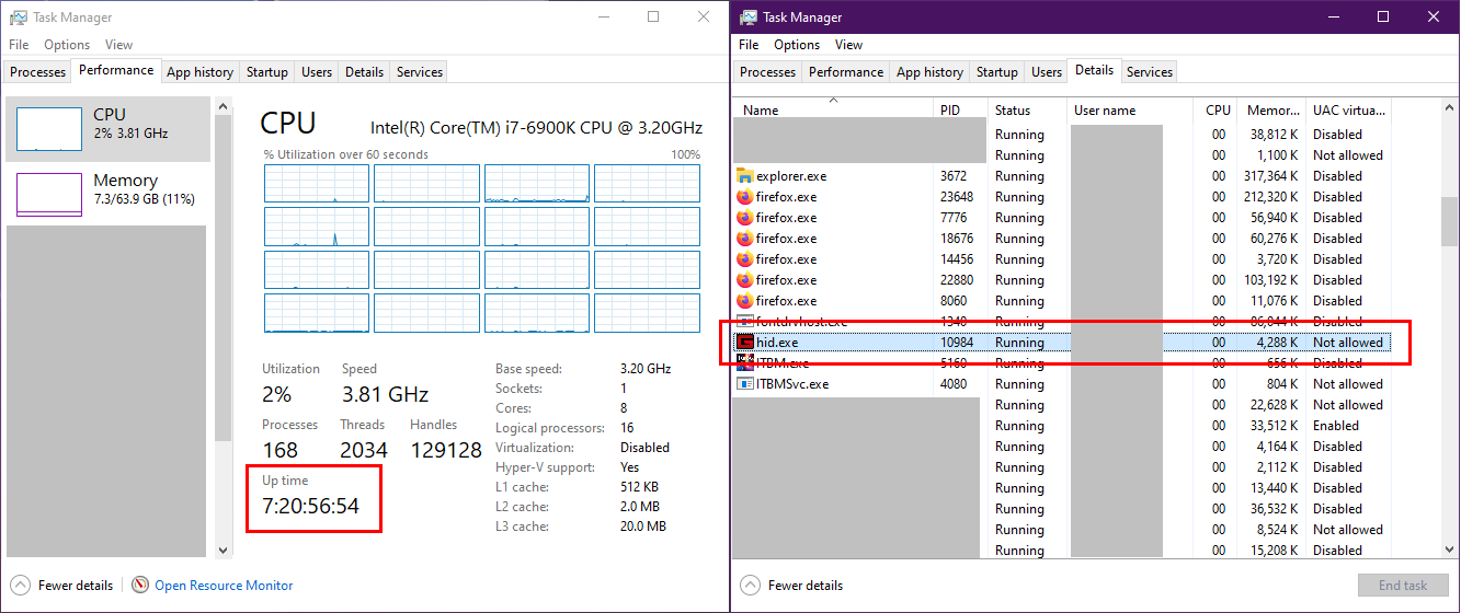

            1. We understand that it doesn't crop up right away. We've had test and work systems running continuously and have not been able to see your issue. This is a screenshot of one of our work systems that has Trident Z RGB modules installed, with the Trident Z Lighting Control software running 24/7 until it's rebooted once every week or two. In this screenshot, it's been on for 7 days. On this system and other test systems, we have not been able to replicate the high CPU usage issue you have experienced.
Name:	task manager hid cpu usage.png
            2. Again, it's not about the RGB Fusion software that we're concerned about. It's about the lighting driver files that RGB Fusion installs on the system. From the beginning we've been trying to explain that this may be the cause of conflicts that may result in the high CPU usage. But we are unable to replicate such issues on our test systems, even if we install the same version of RGB Fusion that you have indicated. This is why we ask you to try a clean uninstall and update the RGB Fusion software to see whether or not if it's an old/outdated driver file that's causing the CPU usage.
