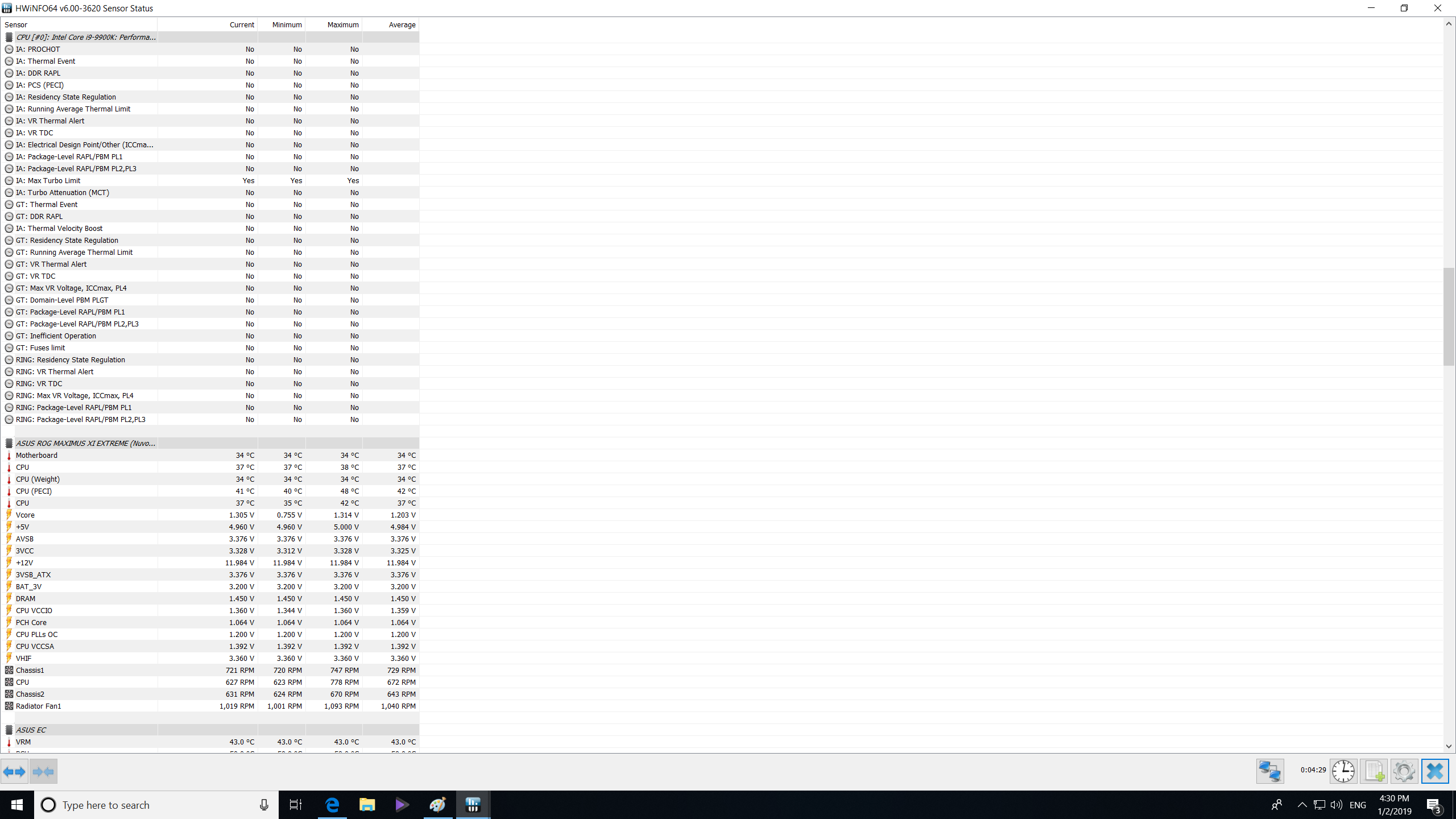

                        ok in your last post you are in the right menu for VCCIO and VCCSA voltage please reduce them now:
                        VCCIO=1.15
                        VCCSA= 1.25V
                        should be more than enough for 3600mhz/3700mhz , please check and test if you can go higher than 3700mhz
                        maybe you can make some screenshots from the bios ram timings @3700mhz
                        (and please don`t OC your cpu/uncore while testing new ddr4 clockrates)
                        in the pic i marked the voltages and they are extreme high - IMO too high and maybe over time little bit dangerous -
                        for coffee lake cpu`s is a max recommended from 1.25V VCCIO and 1.30V VCCSA - and some pages say 1.20V and 1.25V
                        most times VCCSA should be 0.05V higher than VCCIO, sometimes it s better if VCCSA is 0.10V higher than VCCIO and sometimes they have to be equal.
                        1.4V for VDIMM is ok, also 1.45V - if we get your ram running on the desired clockrate you can reduce it and test for stability
