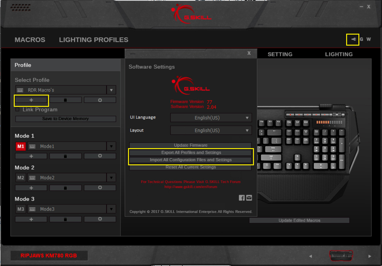

        This is my solution to manage these issues:
        1. Do a firmware reset, this will delete all your macro/lighting profiles and macros on the firmware of the keyboard. (or you could manually delete all macros and profiles).
        2. Setup all your macros again and assign them to your preferred M1,M2,M3 profiles and G-keys etc. (Very annoying but something I've had to get used to doing multiple times.)
        3. Once you've gotten everything saved the way you want. Go to the spanner Icon in the top right and choose "Export all profiles and settings". (save them to a known location, I have a folder on my desktop specifically for the keyboard settings).
        4. WHEN (not if) your macros and all your setting become messed up, go and delete all your macros and all your profiles. (if you don't and just try to import your saved settings it will create duplicates of your macros and profiles. For example a macro named "Macro 1" will be copied and you'll end up with "Macro 1 (1)" , Profile 1(1) etc.
        If you've saved a profile to keyboard memory you will need to hit the + (plus) sign under the select profile and create a blank New Profile and save it to the keyboard memory in order to be able to delete your old one. This is because you cannot delete a profile while its saved to keyboard memory. Creating a new profile will lag out the software and you'll need to wait a minute for it to load a new profile in, strangely importing all the config files and settings doesn't lag anything at all, probably because it's not overwriting/writing anything.
        5. Once all your macro's and profiles are deleted and its back to being blank, go to the spanner icon and choose "Import all configuration files and settings". This should put everything back to the way you've set it up.
        One more tip about editing the macros, it is fraught with danger, it can wipe and remove everything, you'll click to edit a timing and it will record the numpad key instead of the actually number/time you want to insert. I've found that if this starts happening you need to select the option below and click edit and it will select the option above to allow you to edit the timing. It's so weird, I'll try to demonstrate:
        In this example i've got the Q key being pressed a couple of times.
        Q (button down)
        0.08 seconds delay ----To edit this delay you will usually need to select the 'Q' (button Up) option below for it to allow you to edit the timing.This happens often.
        Q (button up)
        1.53 seconds delay
        Q (button down)
        0.08 seconds delay
        Q (button up)
        1.53 seconds delay
        Q (button down)
        0.08 seconds delay
        Q (button up)
        Its just so disappointing the software is so under developed, If the software functioned the way it should the keyboard would be flawless and I'd be telling everyone i know to buy it. If i was a smarter person I would probably attempt to reverse engineer the software and fix it myself.
        Thank you again for replying. I doubt the software will ever be fixed. Sad :*(
        Kind regards,
        Guerrilla
        Attached is a quick pic of the software with areas i've highlighted
