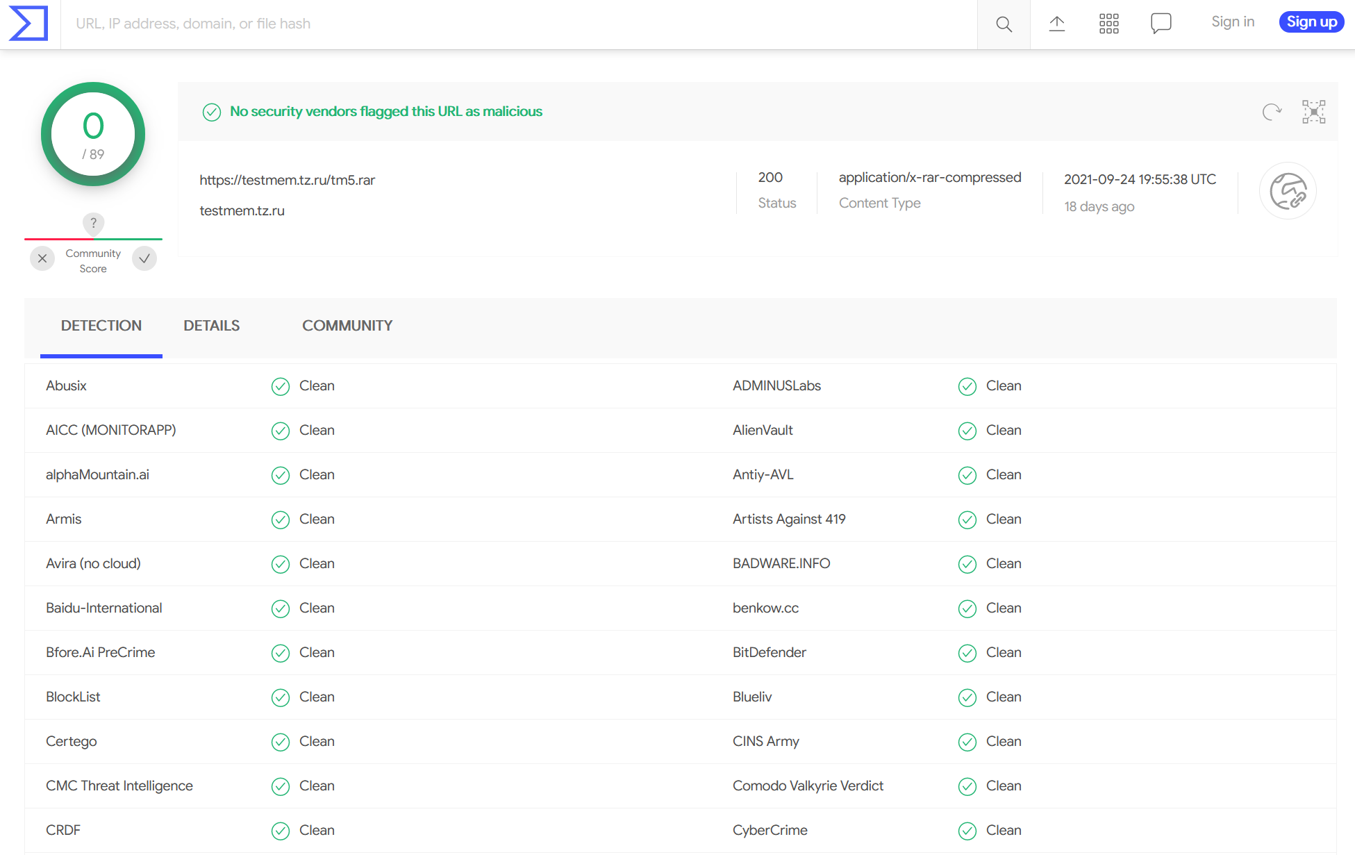

            • #36
              Get TestMem5 straight from the source: https://testmem.tz.ru/testmem5.htm
              When in doubt, always scan a download with virustotal:
              https://www.virustotal.com/gui/url/a...445efa84a412d0
              The configuration files are just plain text that you can safely C+P from anywhere. The most recent Anta777 is this one:
              https://drive.google.com/file/d/1cEq...ew?usp=sharing
              • #37
                Excellent!
                Thanks again... I will be back at it tomorrow and give this stuff a shot.
                I did try that link to Testmem5 prior and just now. Malware Bytes is flagging the site as malicious...
                Nice and quiet up here on the island. But no Internet, so I have to cell tether.
                Take care and thanks,
                LB
