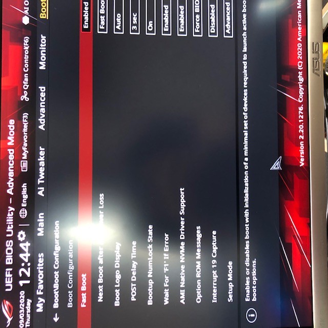

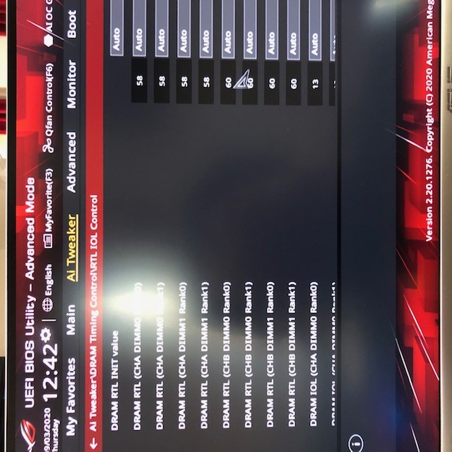

          Hi Thanks!!
          So far it has not worked
          I'm attaching a couple of screen shots to make sure I understood the settings you mentioned correctly. The MCH Fast Boot I understood to be the plain "Fast Boot" setting. That is enabled by default. The only reference to Round Trip Latency I found was the RTL screen with a large number of settings -- I did not touch those. Screen shoots attached.

            MCH fast boot is a different option, you should find it further down in the memory timing section.
            Round Trip Latency is among the advanced dram training options, one menu level deeper.
