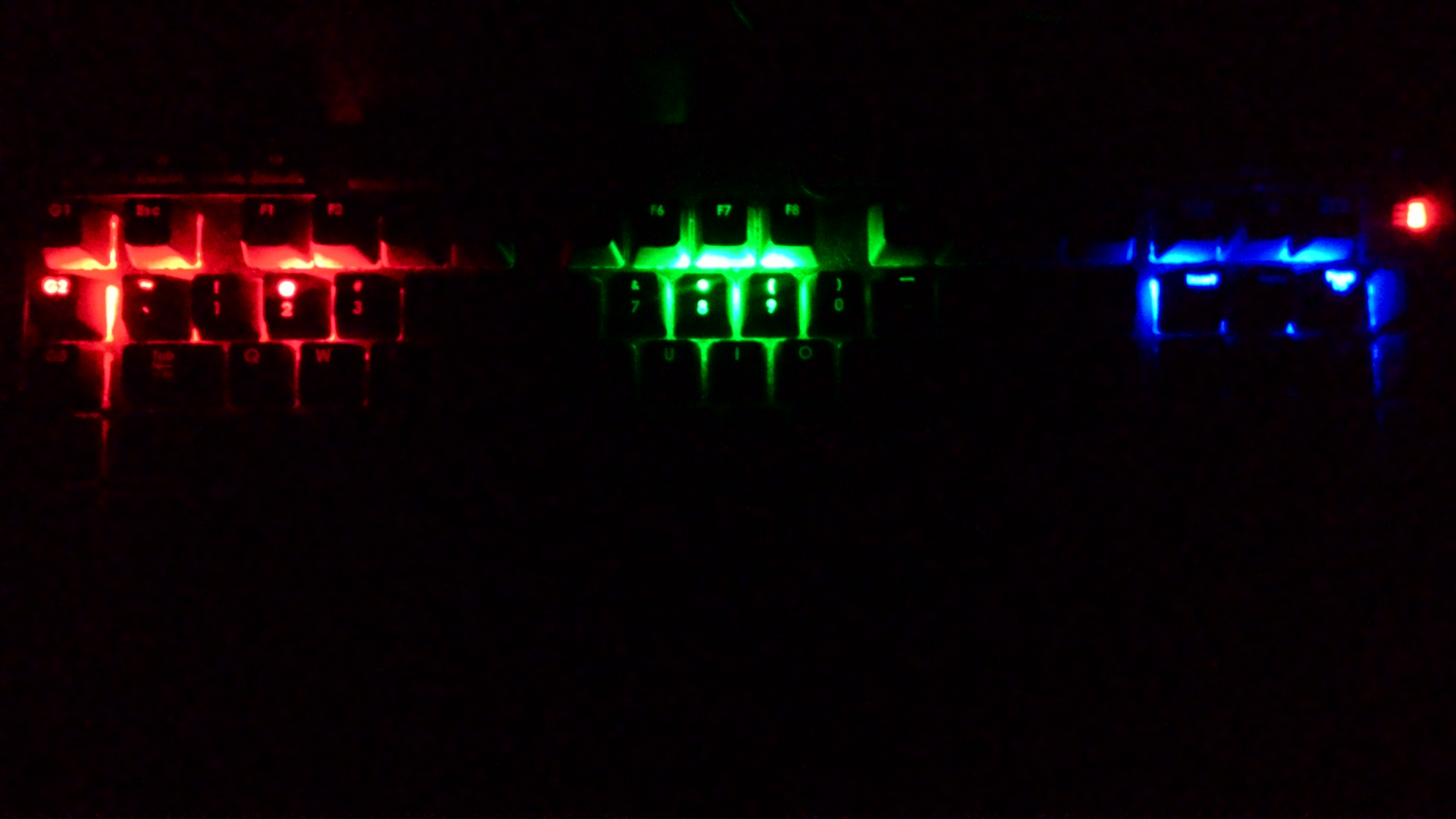

PROBLEM 01 :- Whenever I turn OFF the keyboard lights via "Disable Lighting" (I have set M3 for Disable Lighting), some of the switches have lighting ON even when Lighting
turned OFF.
PROBLEM 02 :- When I SHUT DOWN PC, many (not all, mostly the upper 3 rows and after pressing any switch all lights turn ON) of the switches are still ON but in a buggy manner
[displayed in the video and image provided] and this happens in every lighting effect and also in "Disabled Ligting" mode.
https://www.youtube.com/watch?v=eRYe...ature=youtu.be
PROBLEM 03 :- Some of the Lights have a different base color. When I keep the base lights White, some of the switches have yellow/red/blue/others base color or tint.
