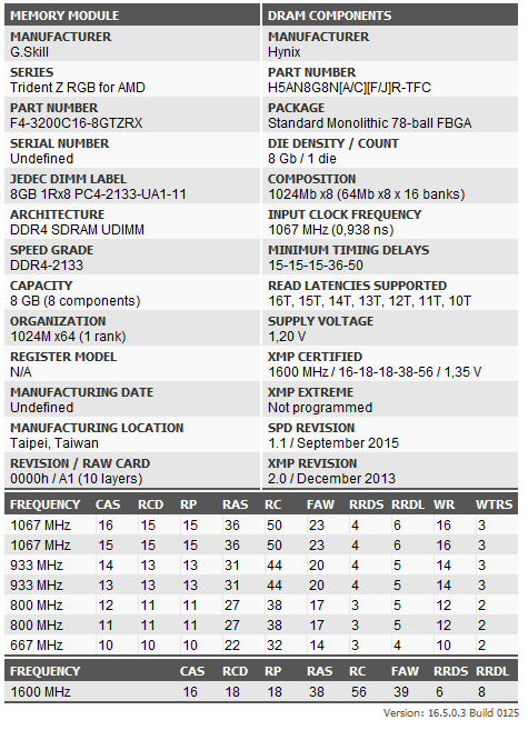

      I was afraid ... but before making an RMA I want to be sure of what I raise, I made a couple of screenshots with Thaiphoon so that they can help me identify what chip class incorporate my memories because the software does not indicate precisely what type of chip they carry and generates serious doubts when testing with DRAM Calculator for ryzen
      The first screenshot is of the memory with Hynix chip and I am not able to identify which type it is, Hynix MFR / Hynix AFR / Hynix CJR / Hynix DJR.

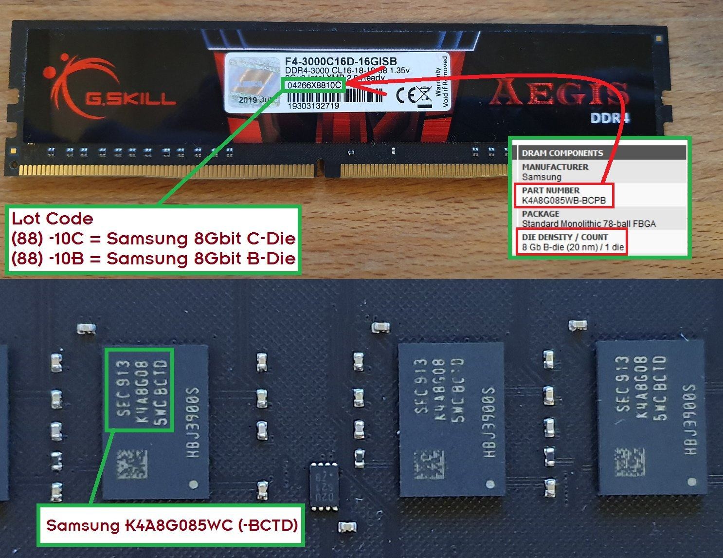

        If you want to confirm the die revision, you need to check the labels. The last letter of the lot code above the barcode tells you the actual die revision.
        Taken from my B-die list at Hardwareluxx:
