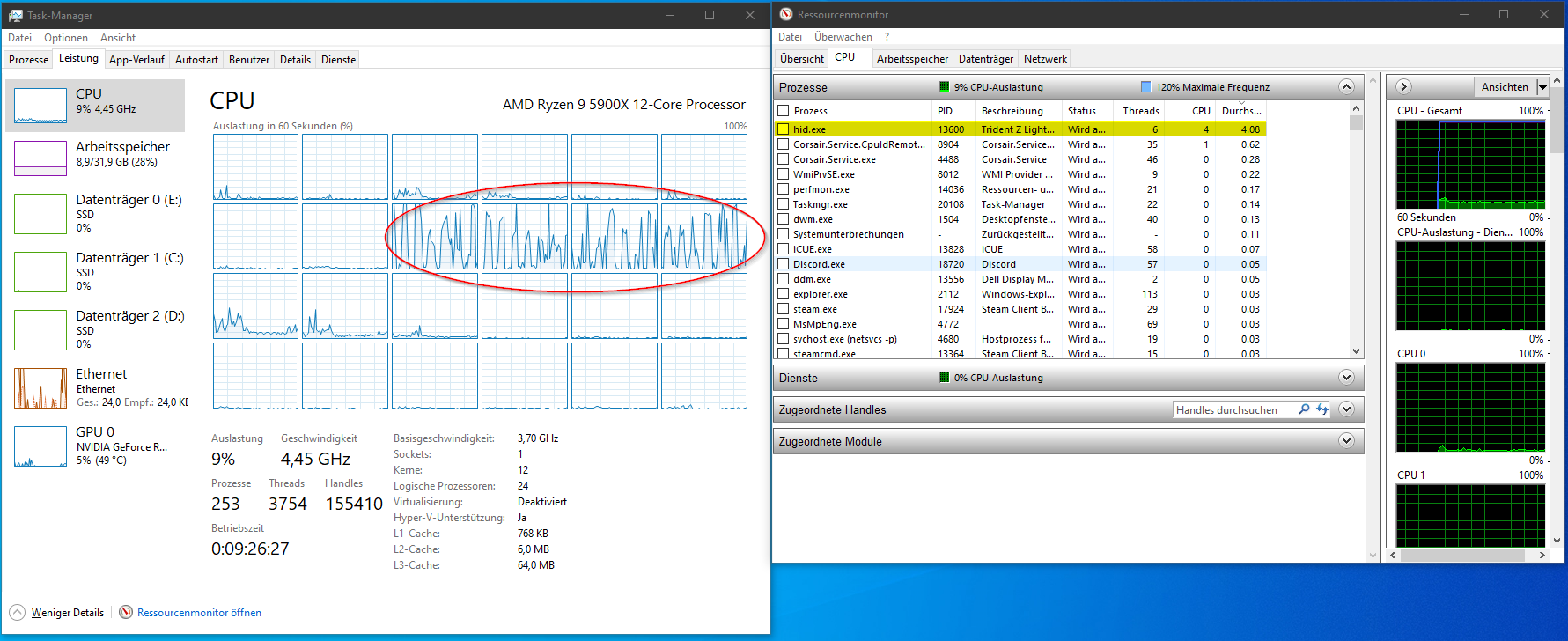

                Here are some screenshots about the issue: Running hid.exe
                Click image for larger version  Name:	hid_exe_running.png Views:	0 Size:	238.7 KB ID:	165833
                And now killing the process:
                Click image for larger version  Name:	hid_exe_stopped.png Views:	0 Size:	190.9 KB ID:	165834
                This issue should get some priority as it will literally cost money when the CPU is using power for nothing. It's also generating heat and unnecessary wear on parts.
