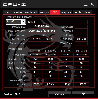

It's hard to 'be patient' when GSkill has given very little responses here. once I installed the broken software, I could no longer go above 2133. 2600 no. 2666 no. 2800 no. 3000 no. on my Rampage 10 w/ 5930k, the Corsair Doms I had easily ran those speeds.

I guess the problem why you cannot go any higher then the default speed is because of the spd is broken/overwritten with random values. If you set the speed higher or activate the xmp profile the random values are used and the system cant start. I would use full manual timings if it is available on your mainboard that should be a work arround to still use the rams in higher speeds. Or use the other solution here in the thread to reprogramm your spd.

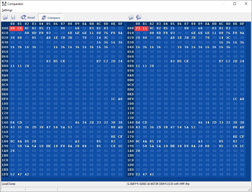

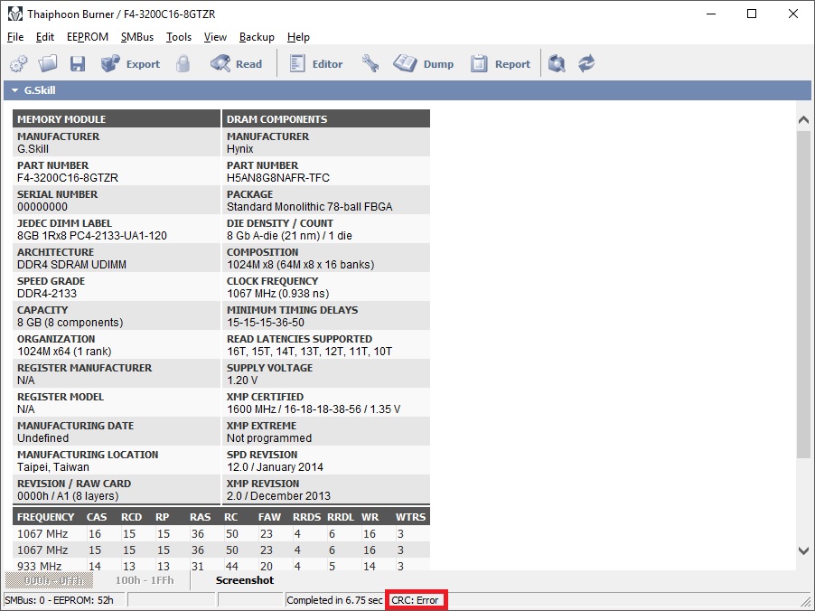

I opened the software, and it runs through, see picts below, but it does come up with CRC error, now ive managed to download the exact same SPD file for my ram from the database, and compared the 2, got a couple of red markers, I guess this is whats wrong with mine.
Im in 2 minds to be honest, I dont know if its due to my motherboard bios as im on a RyZen system and maybe they have not just quite got it right yet, or if it is actually the ram.
Apart from the CRC error and the red marks on the compare, nothing else appears wrong, except it wont always run at 3200mhz, but thats just RyZen at the moment for you.
Just cant find any guides on how to actually flash this replacement SPD file to my rams.
Mine came back error, is there a way to fix this so it shows OK again?
