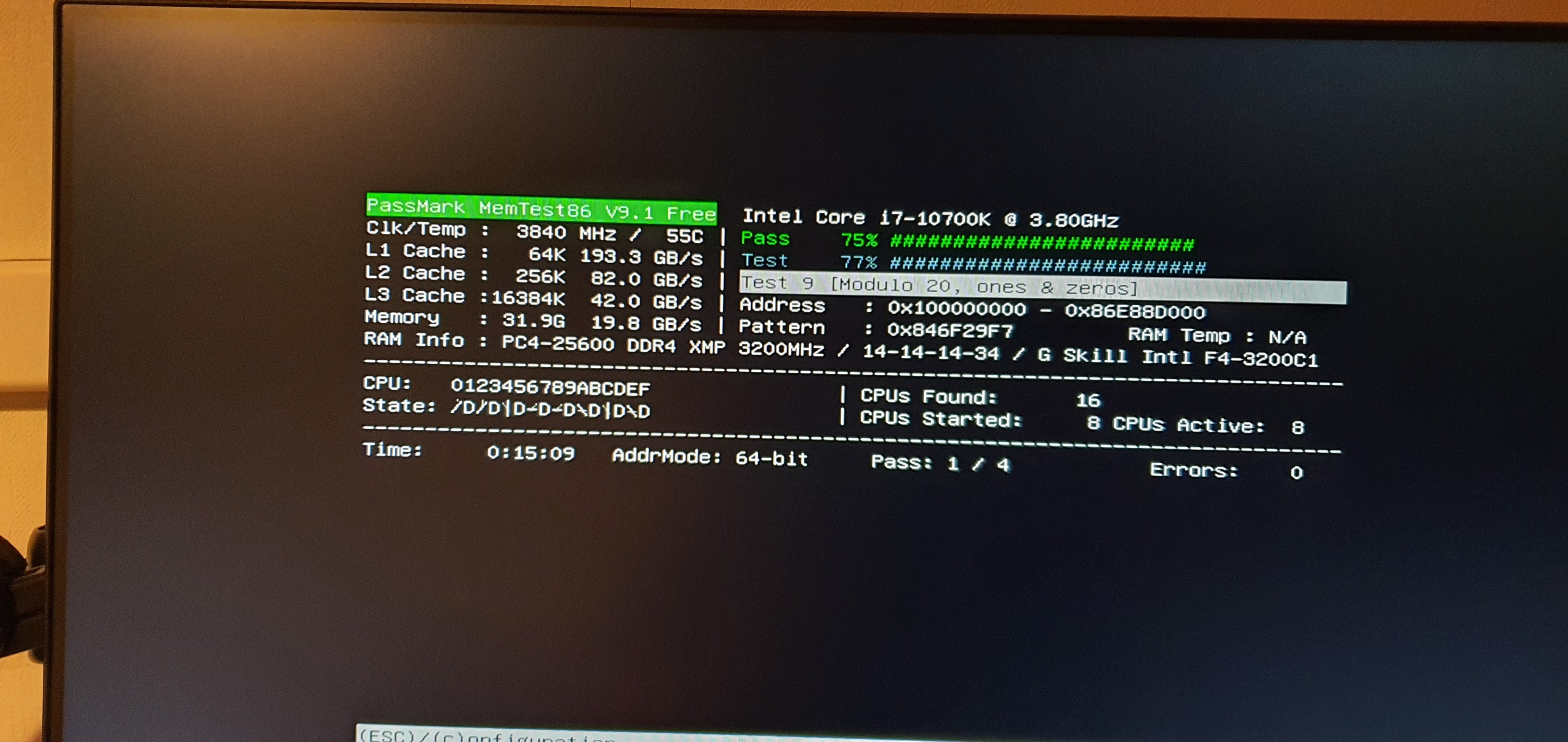

    These are the result of memtest Click image for larger version

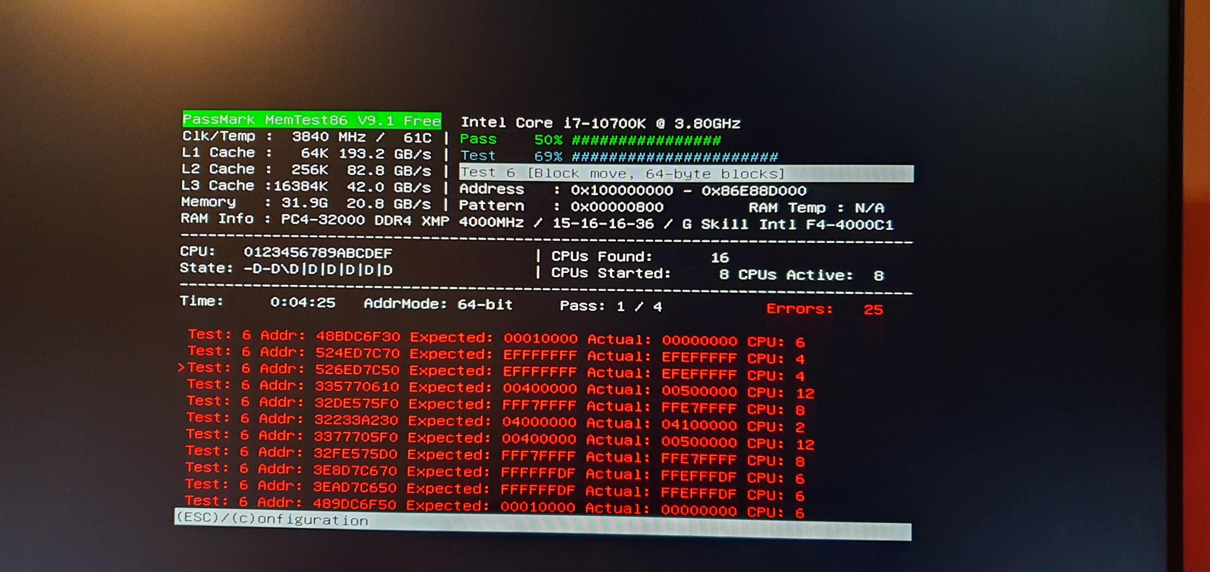

      Thank you for response i have made rma at the shop where i bought it from i did a test again with mine other system ram and system runs fine but when i run test again 4000mhz c15 erorr shows see picture one is ok that is 3200mhz c14 the other with erorr is c15 4000mhz

        Does not appear to be correct so you may need to take them back for a replacement.
