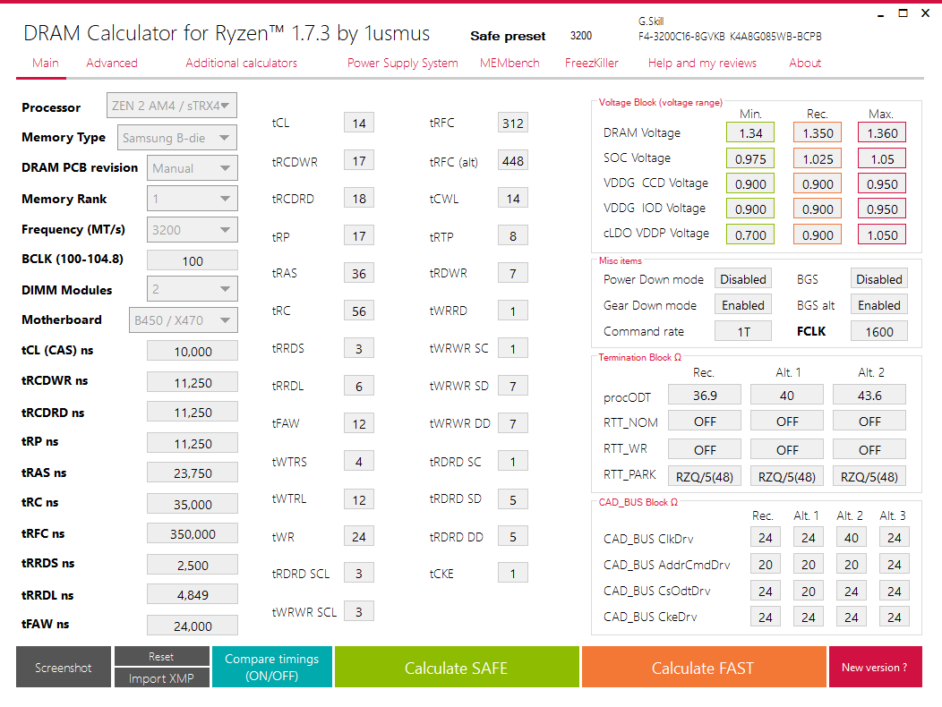

    Instead of using the DOCP profile, I tried using the "Safe" DRAM Calculator for Ryzen settings with the imported XMP profile from Thaiphoon:
Name:	Annotation 2020-07-13 194251.png
    Unfortunately, these settings don't even let my system boot past the POST...
    I realise the B550 Mobo is quite new, so maybe DRAM calculator can't be used yet for this?
