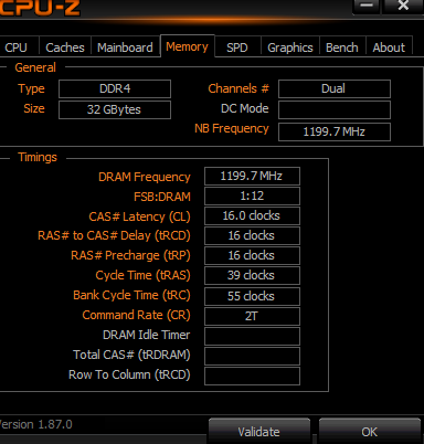

                        Here are the screen shots from CPU-Z:
                        Click image for larger version  Name:	Annotation 2020-02-28 231309.png Views:	0 Size:	24.1 KB ID:	163888Click image for larger version  Name:	Annotation 2020-02-28 231335.png Views:	0 Size:	29.8 KB ID:	163889
                        Can someone help me understand what's wrong? Are the memories not compatible with my new system? Did i get defective ones?
                        I've run memory tests (the ones integrated in windows 10), no errors. The system is unstable with 2 DIMMS and also with 4. So is not like having all 4 DIMMS in use, is the root cause...
