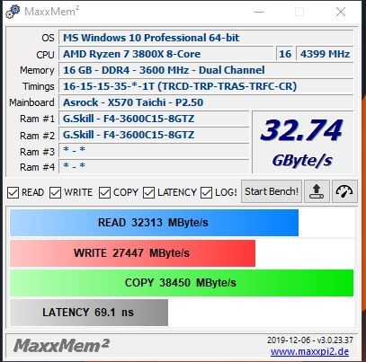

          Not the most impressive results...

            Another benchmark. I am getting very bad latency results. Should I be entering the values manually instead of XMP that I am using today? Would this change anything?
