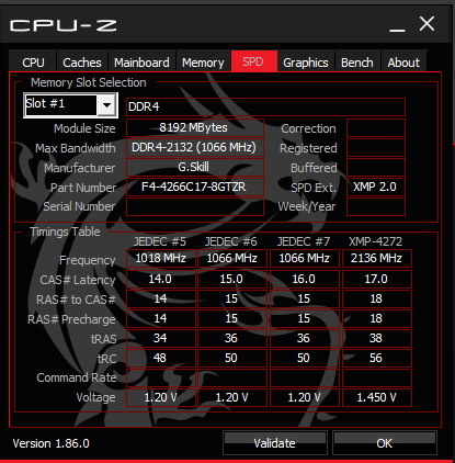

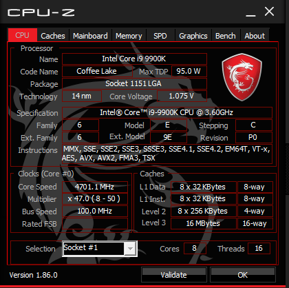

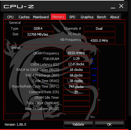

            Please check the attached files (ZIP) for better understanding of the system (AIDA64 Hardware report, MSINFO report & memtest falis), maybe they can help.
            Timings for the 3866 (which I'm currently running are the same as XMP), seem to be stable. (CPUZ Screenshots)

              1. XMP is same in any case; it can be enabled in BIOS. In the same area, there is an option for DRAM Frequency, you can manually change this while maintaining other settings such as timings and Voltage.
              2. Latest BIOS should have all the necessary updates.
              Since DDR4-3866 works, check the VCCSA Voltage, manually set it, then scale up along with DRAM Frequency to see if you have stabilize DDR4-4000+
              Another method is to try each stick to see if they can reach higher. Doing so reduces some load since it is single module, but the result can give you a better idea of what the system is capable of.
