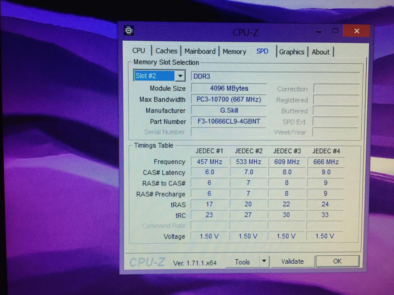

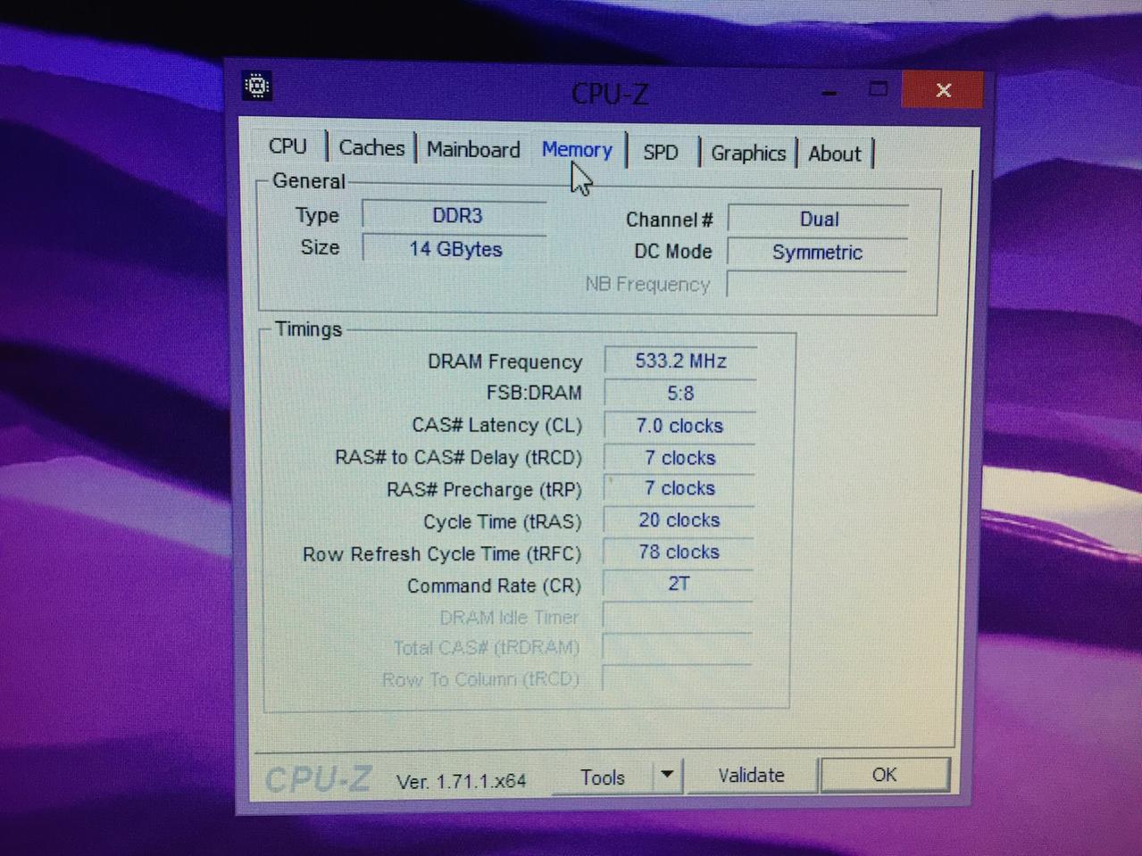

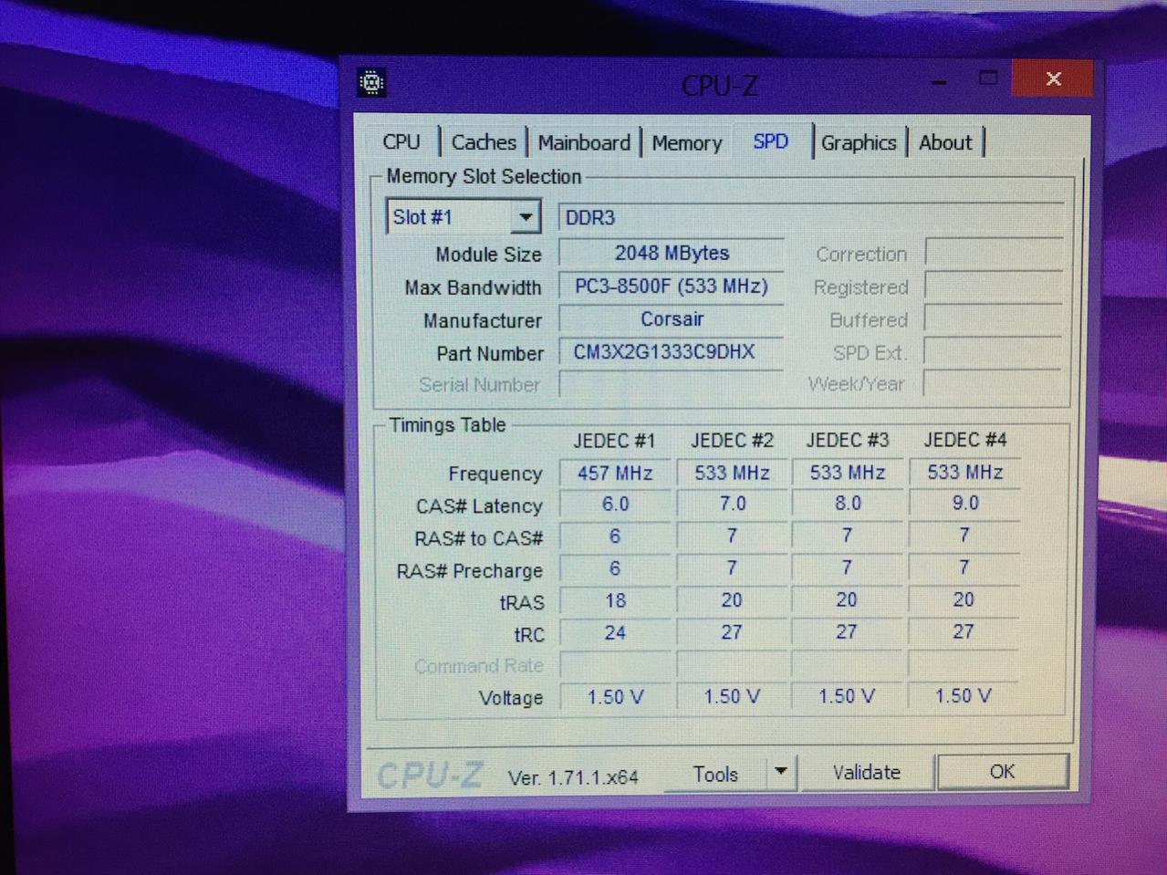

                      New Memory not Posting w/o Old Memory Installed
                      I ordered two kits of F3-10666CL9D-8GBNT for my ASUS P5Q3 Deluxe after following this thread. When I installed one of the Kits, I could not get the MOBO to post. Doing some more troubleshooting, I found that I cannot post unless I have at least one stick of my old memory.
                      I've tried clearing the CMOS then enabling XMS with all settings in AUTO and it still wont post with only one stick installed. I also tried manually adjusting the timing and it still will not post unless I have one of my old sticks installed.
                      I have included some screens of CPU-z with 3 x 4 gb (G. Skill) + 1 x 2 gb (corsair). I would really like to be able to use all 16 gb, but I don't know what else to change / test.

                              • #90
                                Can you post a picture of DRAM timings?
