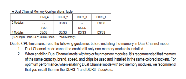

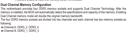

        I think I might of figured it out after doing a little reading.Once I put it in slot 1 it crashed, bumped the voltage on the memory to 1.6v and it was stable no more crashing. Then added the second stick to slot 3 single channel mode, no more issues doesn't crash. Next, I moved the the second stick from slot 3 to slot 2 enabling dual channel mode, no more crashing issues. Works perfectly. Will all this are there any performance adjustments you might make to the settings? Mother board is a GigaByte GA-970A-UD3P rev.2 Click image for larger version
Name:	Dual Memory setup.PNG
ID:	166111Click image for larger version
Name:	Memory stick setup.PNG
