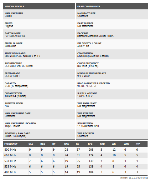

    As per the official JEDEC DDR3 standard all DDR3L modules (1.35V) are designed to also work at the regular DDR3 voltage of 1.5V. The timings are not affected from that, as long as we are speaking of a standard profile and not an Intel Extreme Memory Profile (XMP).
    This is how it looks in Thaiphoon Burner:
      Thank you for your reply, very informative.
      I was under the impression that a 1.35V module would fallback into a more "relaxed" state to work in a different than intended scenario.
      But what you said is clear and as i understand they will be 9-9-9-28, as per the screenshot.
