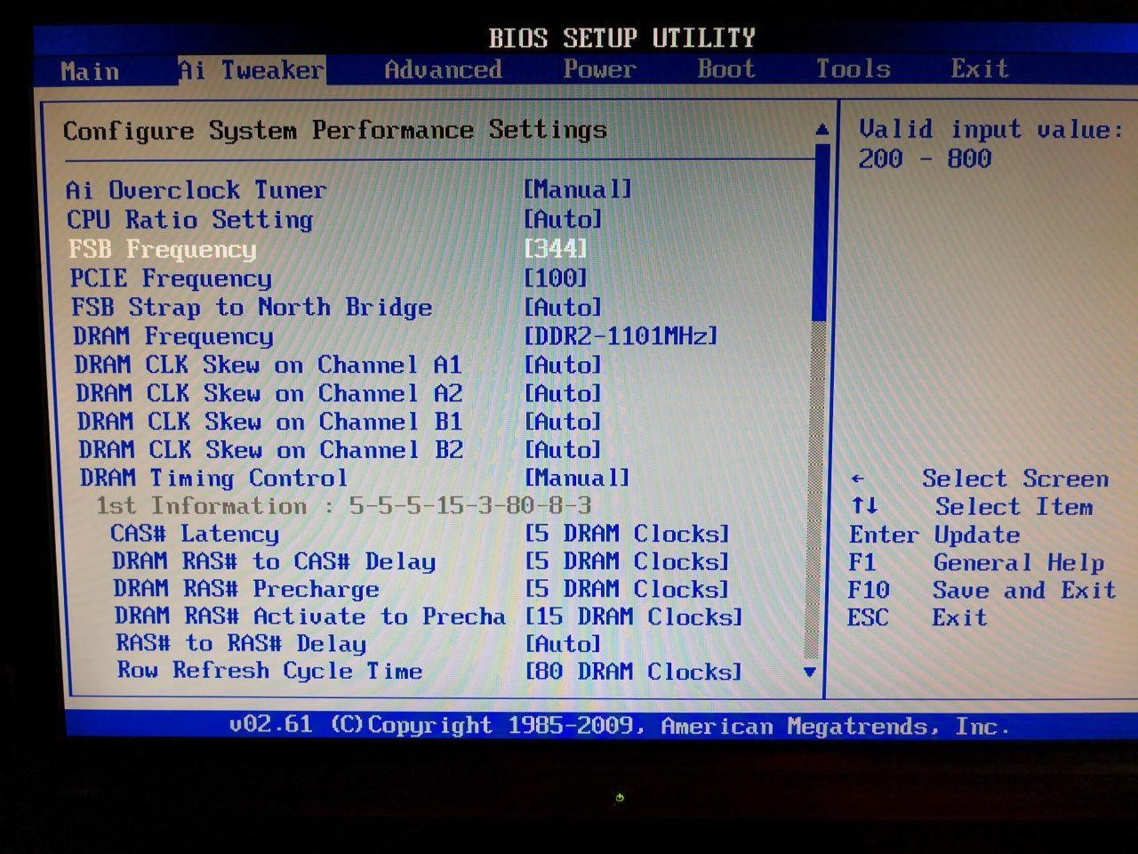

      I'm currently using the settings below 1066 (It seems that for now it is stable) but I don't know if it's the right one. I would like to put it at 1100 if possible.

          Looks good, have you tried increasing FSB Frequency to see if it can reach 1100?
            Yes, you can see it, but i need to know a stable config for this.

                Should I just change the FSB? Don't I have to configure anything else to make it stable at 1100? (In the previous photo i only show that is possible reach 1100).
                  Yes, and may need to adjust Voltages based on results, so testing is necessary.

                          Increase DRAM Voltage to see if that can improve stability. What is your NB Voltage?
                            Originally posted by gskill tech View Post
                            increase dram voltage to see if that can improve stability. What is your nb voltage?
                            DRAM voltage: 2.10
                            NB voltage: 1.40
                              Try adjusting both values to see if stability can be improved.
