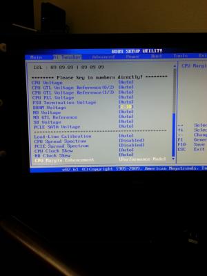

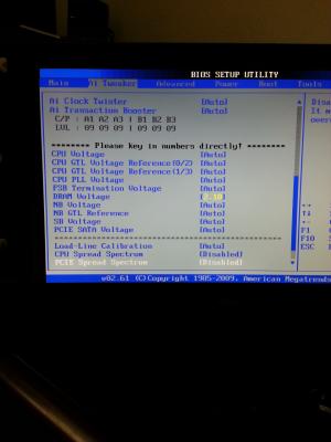

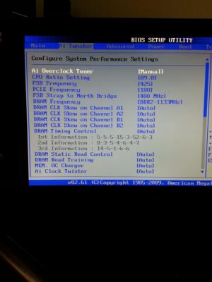

        here are the settings for my bios running with 4gb of RAM. if i try to use this same settings with the 8gb of ram (four sticks) it dont work.
          In the advanced timings looks like it sets to 52 for the tRFC try that at 88
            well i did what you suggested. my board only allowed me to set the tRFC to 85 that was the closer number to your suggestion.
            still i wast not able to boot in to windows. then i did more changes, increase little DRam volt to 2.3 and still not luck. what i ended up doing was to lower my FSB FREQ to 420 and this set the memory's to 1119mhz for the 4 sticks, and lowered my CPU speed to 3.74 that isn't that bad, i would prefer the 3.84mhz as i was with the two sticks, and i was able to boot in to windows now.
            i think im happy with this result, i left the tRFC as you suggested. Im gonna run some benchmarks tomorrow and i post the results.
