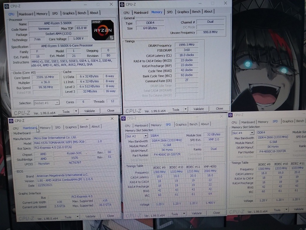

        my son's pc MSI whit - xmp 4000MHZ 2x32GB cl 18 G.skill Intel mem , bios setup volt 1,4v Click image for larger version
Name:	64GB G.Skill TridentZ RGB DDR4 4000Mhz 2x32GB (F4-4000C18D-64GTZR) on AMD 5600x.jpg
