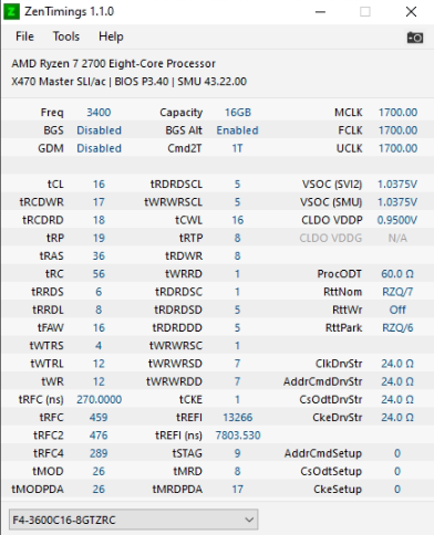

  • The'STRAFF
    replied
    Thanks, I appreciate it. I haven't played with the voltages, I have SoC at 1.05 its normally at like 0.9. I didn't want to push it since the motherboard I have doesn't shutoff when over heating, apparently.
    I will probably first try dropping timings to match yours or lower then what I currently have set, before I try attempting higher frequencies.
    I have gotten to 3600MHz and that was probably at SoC ~0.95, maybe I will try getting to 3600Mhz error free, but clear_cmos is not an easy thing to do with a closed case.
    Leave a comment:
  • JeffyW
    replied
    Quick note, I was able to run through TM5 and some of the memtest benchmarks at 3400 (and even 3466) without error at 1.025 SoC voltage, but was getting some random crashes from games. Ultimately I bumped the SoC voltage to 1.125 and have been error free ever since. I haven't tried to dial that back down to find a lower voltage, but I did want to give you that heads up. I did try to bump the frequency with the higher SoC voltage, but wasn't successful.
    Leave a comment:
  • The'STRAFF
    replied
    Thanks, I will try this, i have mine at 3400MHz - i havent played with the timings.- i just wanted to get it to a point where there are no memory errors, i have got it to 3600MHz but with one too many memory errors. - my pc booted with this https://imgur.com/a/ENMKRBo @ 3566 but now its a no go, im stuck at 3400MHz for now.
Name:	3400 timings.png
    Leave a comment:

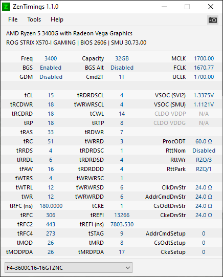

  • JeffyW
    replied
    Here are the timings I'm currently running (and have been running for quite some time now). Seem to be super stable. I tried running 3533 and even 3466, but no dice. The key for me was geardown mode off. I can bump tRCDWR to 16, but RD doesn't work for me below 18.
Name:	ZenTimings - 3400g at 3400mhz.png
    Leave a comment:

  • JeffyW
    replied
    I do have the latest bios (2606). Oddly it won't let me go above 1.35 for DDR voltage (says it's the max).
    Interestingly enough, with a bit more playing I was actually able to get it up to 3400 stable by disabling Gear Down Mode. I noticed that when I set XMP, then changed frequency to anything down to 2933 (as far as I tested), it was enabled, but when everything was on auto at 2133, it was disabled (and that was the only time it was stable), so I took a shot. At 3400 with everything on auto (but GDM disabled, procODT 60), everything was stable, but bumping up to 3533, I immediately got errors, so I settled back down to 3400 and tightened all the timings based on DRAM calculator. I was also happy to see it stayed stable with a 1T command rate. Considering this CPU is only a zen+, and it's just to hold me over another few months, I'm happy with where I was able to get it.
    Leave a comment:
