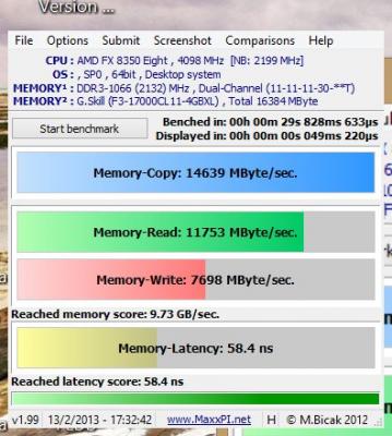

          I have the same mobo. Except I have an FX8350 and different GSkill memory. With Auto settings I would post at 1866 but not 2133. I didn't have to OC anything, I assume our mobo did it for me, but I did have to manually set the DRAM voltage to 1.65v and change the DRAM Command Rate: 1T (Auto) to 2T as well. Let everything else stay on Auto and fine tune after a successful POST. Hope it works for you

              Other than checking my fan speed and the bogus negative core temps on my CPU I must confess I've never used AOD I do know when I used a Bulldozer 8120 I could only get two sticks to run at 2133 and not all four but they would all run at 1866. With my Piledriver I can get all four running at 2133 with the methods stated in my previous post and the motherboard seems to do a mild OC on it's own when I set it any higher than 1600. I'm assuming they beefed up the memory controller on the Piledriver but don't quote me on that. Good luck
