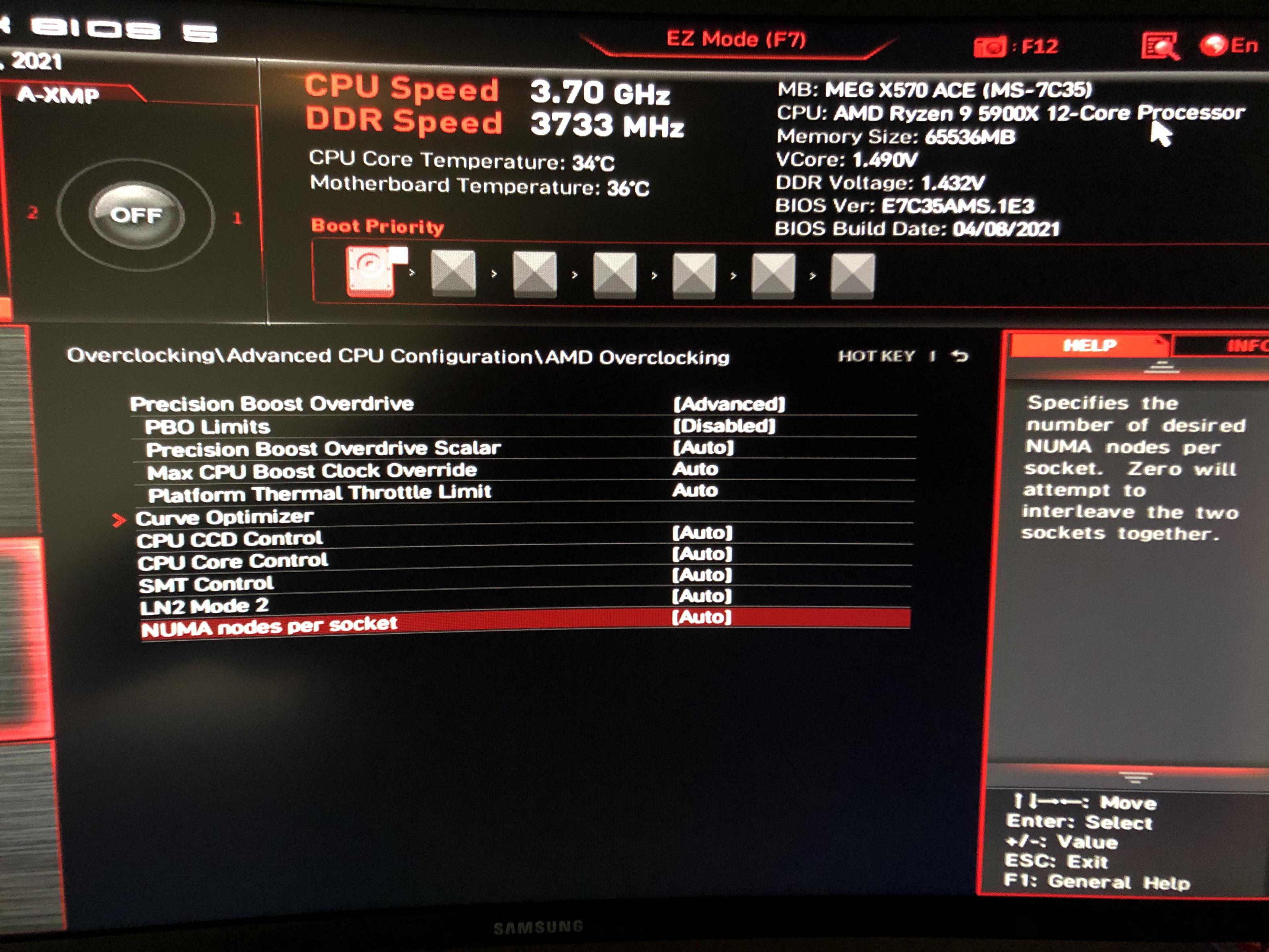

    EDIT: I think I need to specify that I am also starting to OC my cpu, just in case this can be valuable to anyone. Currently I am running “PBO-motherboard settings, Scalar x1, All core/Per core overclocking: Negative 10, Boost clock override 200mhz. “

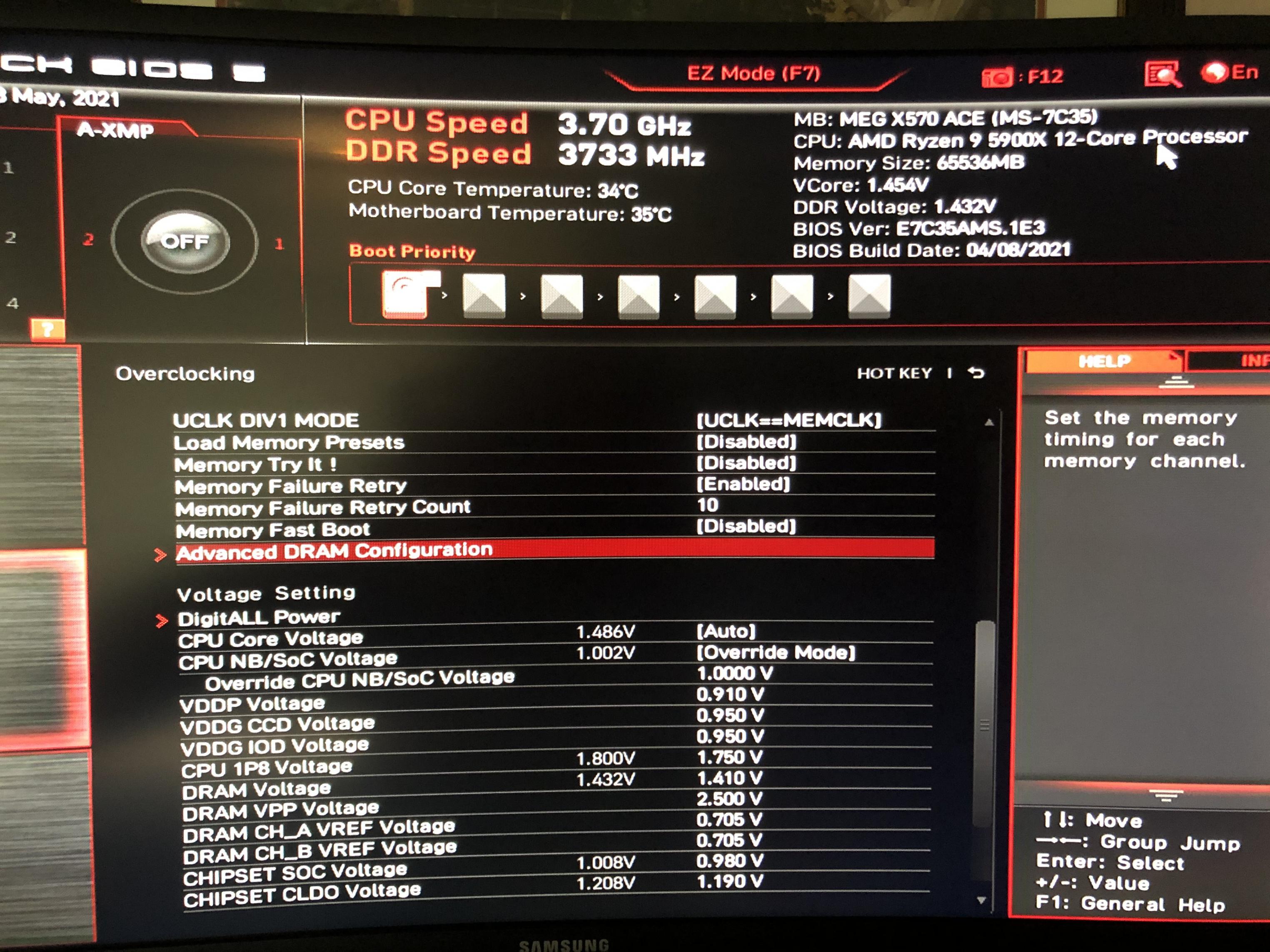

        I have done some other things, (TBH your comment about mobos overcompensating is what caused me to further investigate my situation.) Like I found out I have a voltage called 1P8 that’s supposed to be at 1.8v and the default “auto” was pushing 1.850v.
        I cut a lot of system heat with that one. almost 15c in some instances.
        Also noticed that my SOC was defaulting to 1.1v, and I was able to override it to 1.0v, all while keeping my OC.

        Sure would love to know how to set the VDDP/VDDG, What’s default and what numbers are dangerous to go over, and what happens if you do enter a number higher than the limit?
        Unfortunately for some reason the readouts in my bios has recently glitched, and I can no longer check the voltages, maybe I need to pull the cmos, or my dual boot Linux/Windows has messed something up.
        The readouts are still correct in HWInfo, even if I reset them to auto settings.
        Happy to hear any expertise of what I might be doing wrong, however that’s the style I enjoy, as little voltage as required.
        I’m not sure why I would need 1.1v, if 1.0v on the SOC is working.

          For the VDDP and VDDG, it should be around -50mV of CPU SoC, never to exceed, so it is likely you do not need to make any adjustment.

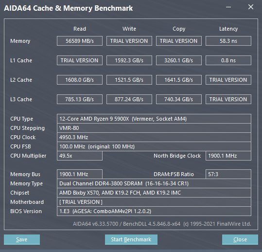

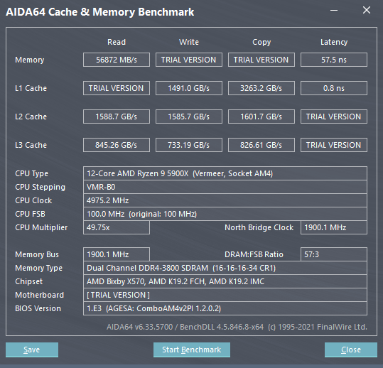

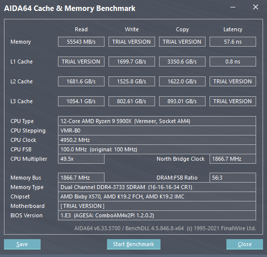

            I have tried my best to get 3800/CL14 to use less voltage but it will not come up with anything less than 1.51v. Im also too afraid to push more than this. I tried running an AIDA64 stress test, and it almost instantly failed. I have one bench mark run, and it matches the lower "3800mhz cl16 PAST" numbers almost identically. I tried again recently to make CL14 run, but it crashed the system while running the benchmark. Other than these times, I haven't ran it more than 1.44v, and haven't done much actual "gaming" stress testing, just lots of desktop idle/benchmark, just checking into programs and leaving, type of stuff.
            Im just worried if my numbers seem OK, the most recent ones seem lower than what I have shown in the past. everything on the PC seems to be operating as usual, and no unusual voltages are present.
            (it also seems that 3733CL16 @1.43v REALLY IS the best place to stay.)

                      Can anyone tell me what numbers are expected for the L3 Cache? Is something wrong with mine? (damaged ram or mobo?)
                      In a forum specific to my mobo, someone told me my L3 cache speeds are "not up to par."
                      Said I needed to install the "Driver fix for the memory cache from MSI.com" No other explanations given.
                      I am running the latest Beta Bios from MSI and I have long before downloaded and installed the AMD chipset drivers from AMD.com. I dont know what else I could be missing, but I also dont know what kind of L3 Cache numbers I am supposed to get?
                      I get the same kind of L3 cache numbers all the way down to 3200mhz
                      Click image for larger version  Name:	recent3800cl16.png Views:	0 Size:	134.4 KB ID:	166895
