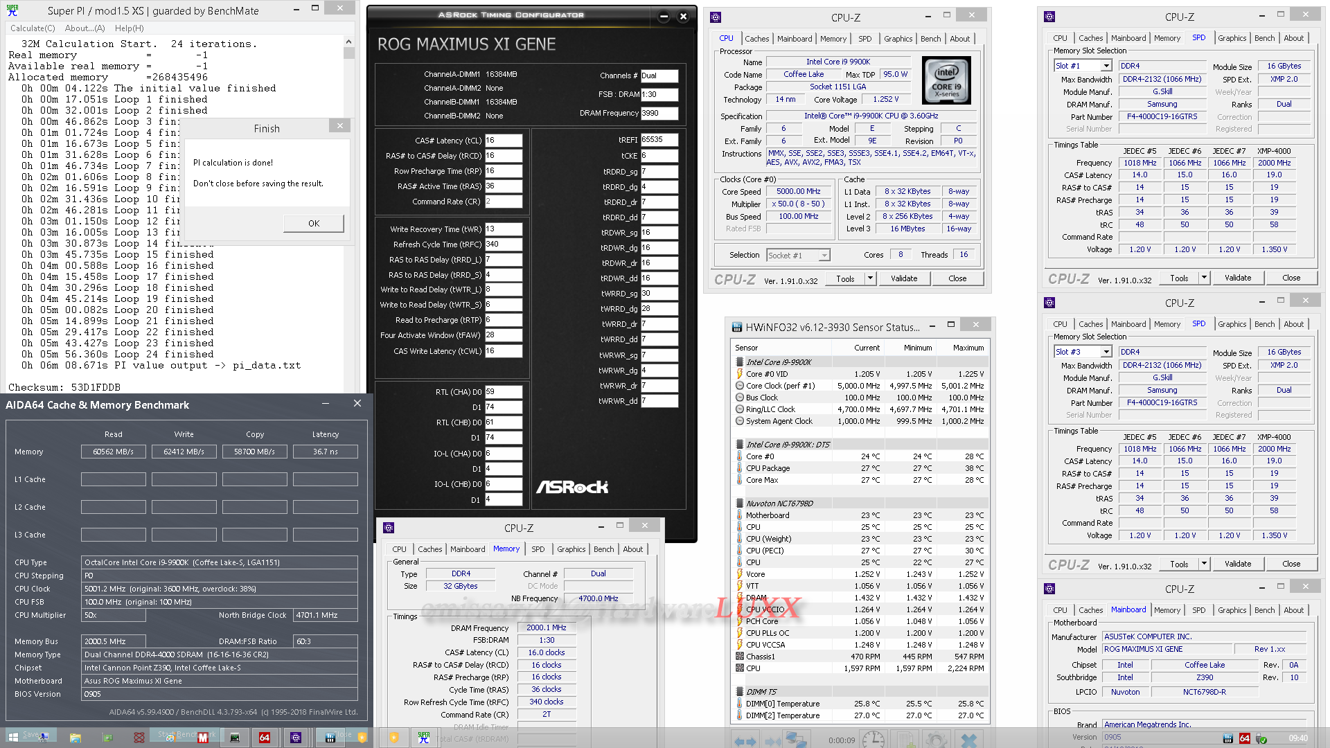

    Do you have some screenshots with the full timings and benchmarks that show the performance gains?
    If you can run 4133 with tRCD/tRP 19, your kit should be able to do so at 4000 as well (esp at the same voltage).

                  Yes, from the product code they are Samsung 8Gbit C-Die.
                  ASRock Timing Configurator or ASUS MemTweakIt have two important uses:
                  1) Checking what values the motherboard trained those timings, that were left on auto and if their values are consistent from start to start.
                  2) To exchange data about your configuration and performance with others. That is also what I am taking it for in my user reviews, example:
Name:	G.SKILL Trident Z Royal F4-4000C19D-32GTRS_4000c16.png
