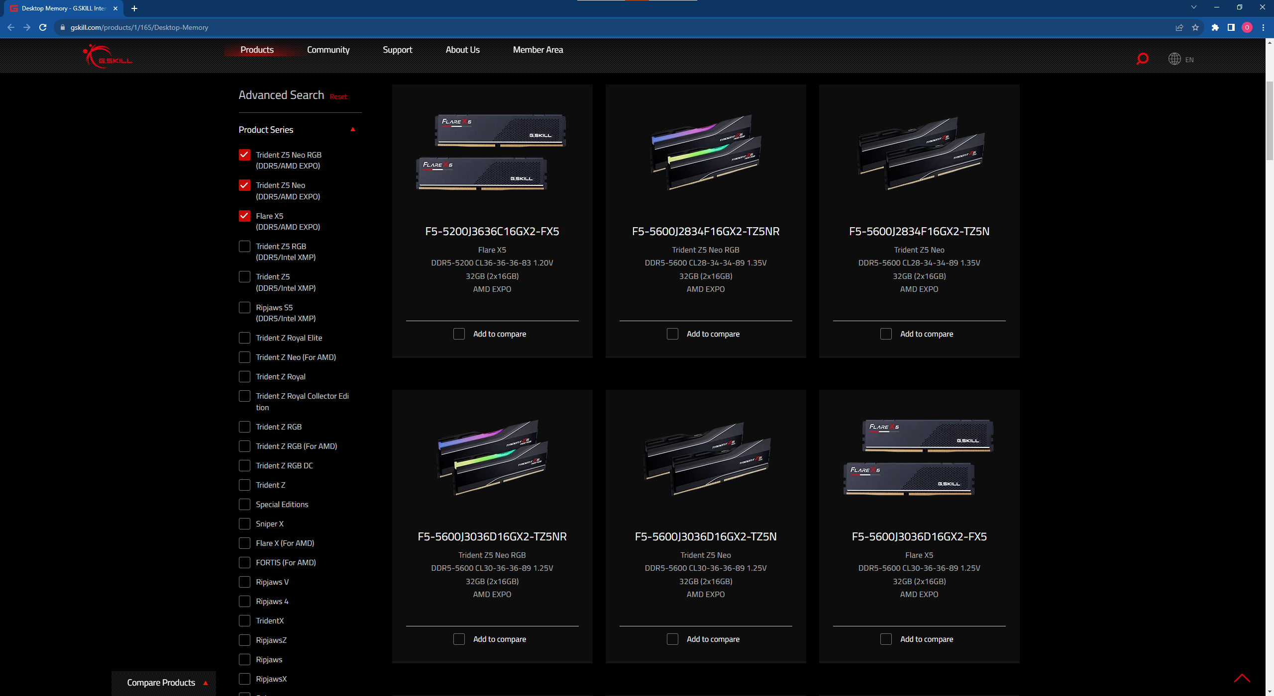

      How is the average Joe supposed to use the (Product Series) filter?
      To me, "Product Series" would be the output / answer of the process, not the input.
      I got a 2560 x 1440 display, but it fits only 6 products on screen, making it harder to use.
      Click image for larger version  Name:	gskill.png Views:	0 Size:	487.4 KB ID:	169432

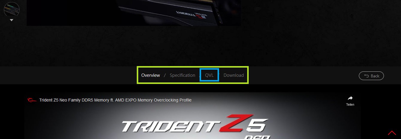

              Support sounds like aftersales, not presales. Where does one find the QVLs?
                Each of the product pages has a QVL tab (where it is applicable).
