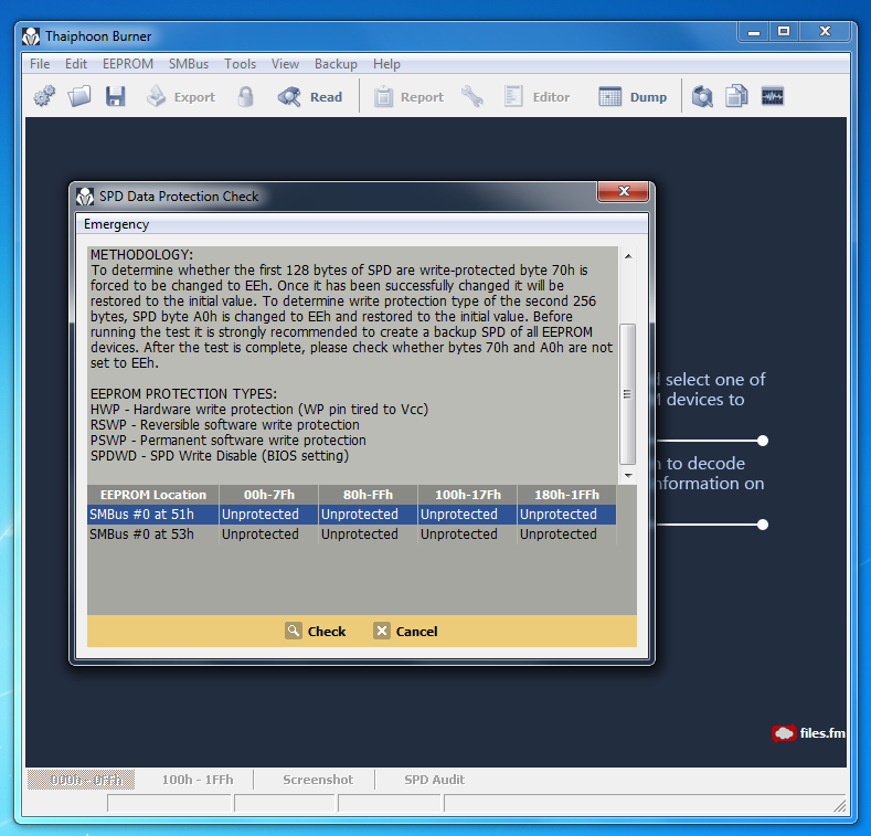

          If there was actual SPD corruption, it would be permanent and would consistently reappear after every reboot with the same checksum(s). From what I can tell it really has not been an issue for quite some time. If you are curious, you can check for write protection status with Thaiphoon Burner. Fully unlocked it looks like this (dev hw):

          Also the link clearly states that enabling the setting is only required for "some Z370 and ASUS X99 motherboards", so it is very rare exception.

            It seems they are protected with Reversible Software Write Protection.

                      It was indeed an issue with RGB and SPD corruption but it seems it was solved months back and SPD is now protected anyway. You can check if it is with Thaiphoon.

                        so mine says software write protection i dunno if that means its always safe, i hope so i would worry less if G skill told them self they provide spd flash tool + spd file for exact kit i have in case happened to me, and if that was not possible i be able return kit for rma trouble free, i really did not want to get a corsair kit, cos with g skill technically works in armoury crate without needing to install trident z software, to bad armoury crate is a mess right now worked perfect last month then they broke it this month.

                          Mine are RSWP - Reverse Software Write Protected and they are most probably safe, it seems the safest than this is the hardware protection.
