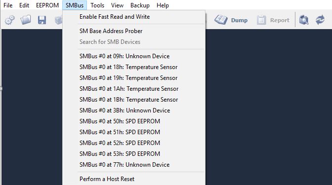

            Hi facehook,
            Find the screenshot attached.
            Thank You

              Thanks! Please read my reply at https://www.gskill.us/forum/showthre...t=14257&page=8
                Thank you for the help, but my issue is different cause i do not see similarities with my modules and the other guys.
