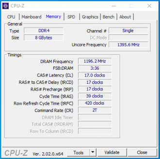

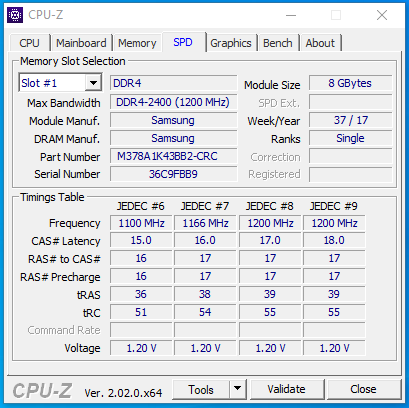

    The existing RAM is a Samsung DDR4-2400 (288 pin), running with CL17, screenshots from CPU-Z below. I've narrowed down some G.Skill Aegis options, this (CL17) or this (CL15), but wonder if they will really run. Both fit the case physically with 30.4mm height, but I wonder if density etc. might cause issues - and I haven't found super clear specs/reqs from Dell either (see owners manual, page 65).

    Density shouldn't be an issue, but you probably won't be able to utilize the XMP of a kit like the F4-2400C15D-32GIS, since OEM systems usually lack support for that. So they would only work at default settings. The specifications on the product page list that as the SPD Speed (DDR4-2133 in this case).
      Thanks emissary, much appreciated. I'm aware that XMP won't work, but chose to accept this for my use cases. I'll just make sure to choose a good CL/SPD speed combo (the CL15-2133 Aegis seems to marginally outperform CL17-2400). Do you happen to know if the Fortis series might create issues for Intel based MBs, aside of being the primary choice for AMD systems? It's got a slightly higher speed (CL15-2400).
        Oh snap, I missed your post. Sorry!
        No, I don't have any experience with the Fortis series. The DDR4-2400 CL15 models probably are CL17 at default and require XMP support for CL15 at that frequency.
          No worries emissary.
          Felt like dropping a final reply: Went with the CL15 sticks and the system works like a charm (as said, without XMP). If anyone is interested I could drop a screenshot of CPU-Z.
