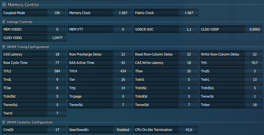

                          Since many of the RAM-related settings in BIOS are seemingly not touched by XMP and set to "auto", I have used Ryzen Master in order to see what the values actually are during operation:
                          With this in mind, what would you suggest I do next?
                            Adjust CPU SoC Voltage to see what values may improve stability especially at a higher DRAM Frequency. Full slots at a high frequency can be stressful for most IMCs.
