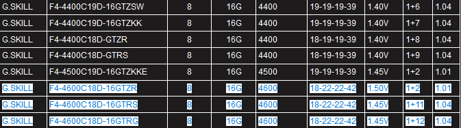

        Ok looking for an update, still had no reply from eurotech@gskill.com, now on the evga support page it specifically shows that my motherboard can handle 4600mhz g skill RAM here is what evga shows for gskill 4400-4600, so to say "We do not have that motherboard rated capable of full XMP specs" is false:
        here is my proof
        Click image for larger version  Name:	evga ram support page.png Views:	0 Size:	18.3 KB ID:	164955
        I have also stated my hyper x ram only of only 4266mhz has no issues hitting 4600mhz with tighter timings cl 18 on 1.4 v.

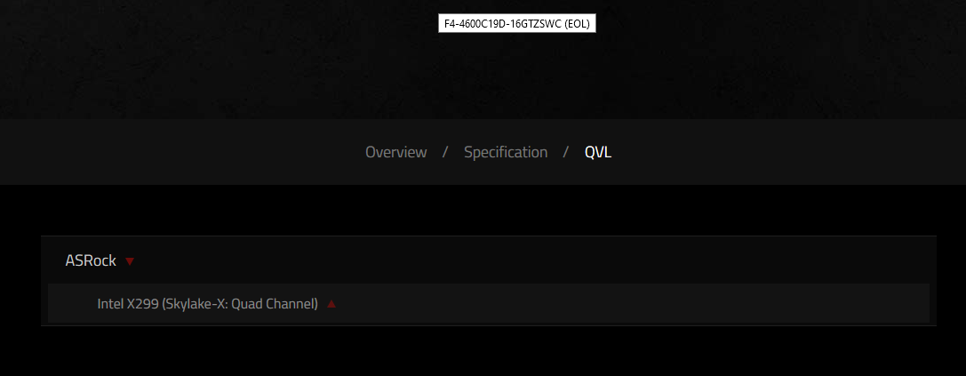

        When I search for my RAM sticks on the gskill RAM configurator for this memory kit it is not listed, only shows on one x299 ASROCK motherboard on the QVL, it is not even a high end overclocking board.
        which shows me that the configurator is not being updated regularly, 'on the box is does not stipulate for intel x299 only'
        So looks like am being misled
        Click image for larger version  Name:	f4600 gskill QVL.png Views:	0 Size:	38.8 KB ID:	164956
        So what your telling me is this RAM is only supported for one motherboard?
