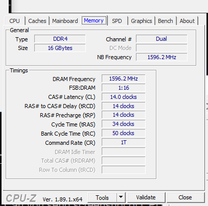

              Can you send screenshot of CPUz memory tab or provide that info?
              Are you attempting DDR4-3200 during all these tests? If so, boosting DRAM Voltage and/or SoC Voltage may improve stability. You can also try a lower frequency such as DDR4-2933 to see if the system can be more stable. We need to determine whether instability is due to settings or the DRAM itself.
