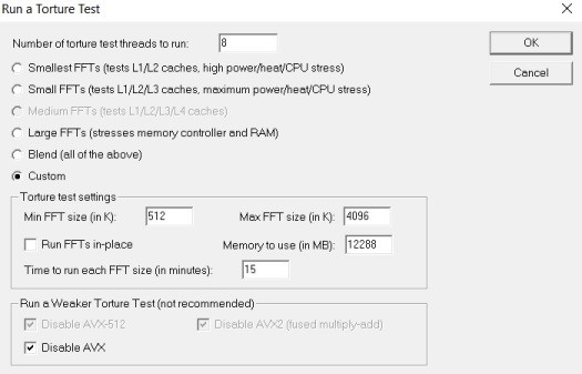

    Prime64 custom memory test settings.

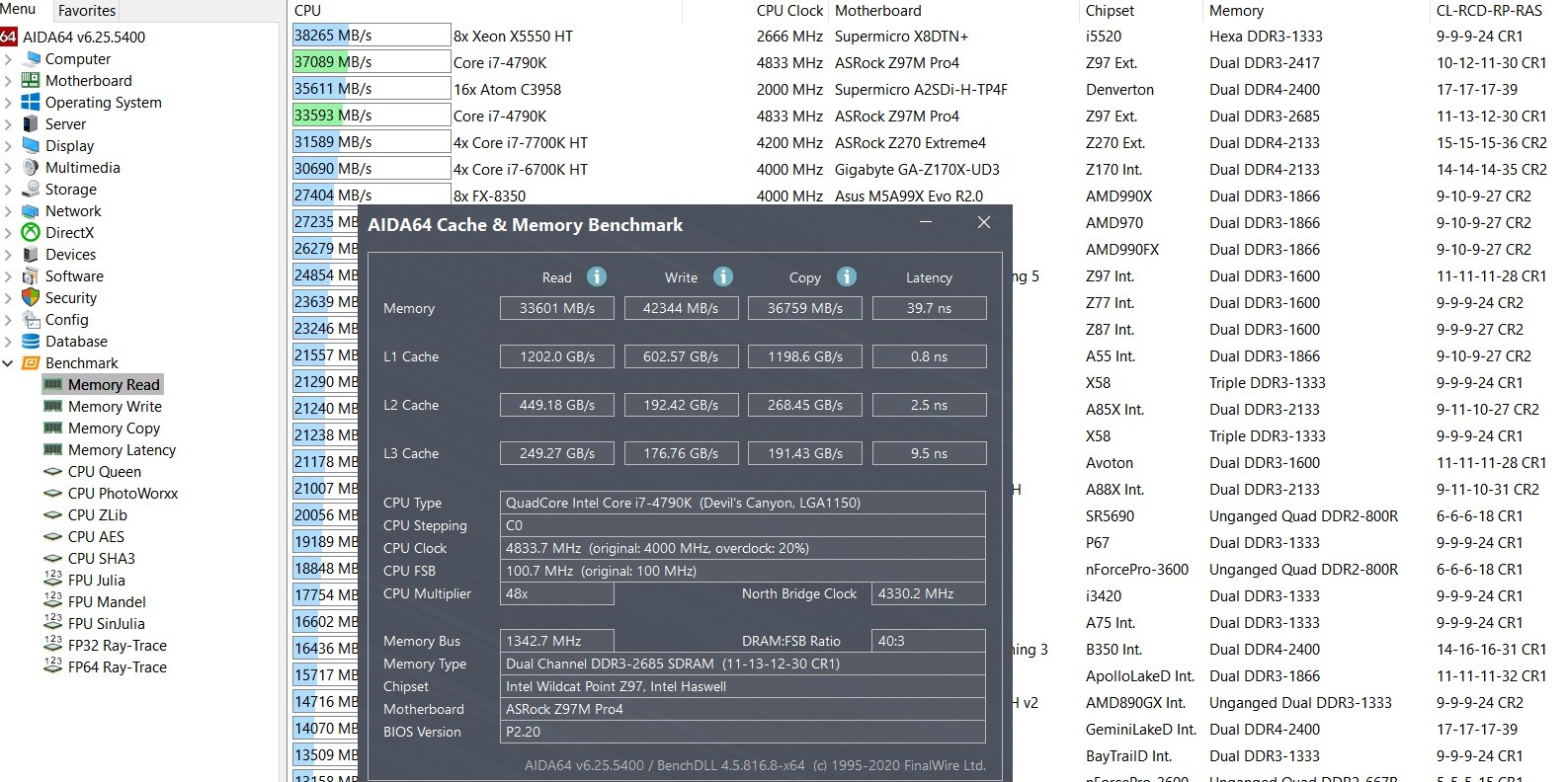

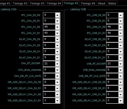

    I have not messed with RTL/IOL, just letting them train on their own. I went ahead and set them to what you see in the pics and it did not seem make much of a difference. How low can I set RTL do you think? IOL is so low I'm leaving it alone for now. I normally test with Prime64 custom memory settings for 8-12 hours when I make changes.

    Could be your board failing to properly train the RTL/IOL with the reduced timings. You have to test that step by step. ATC shows the RTL/IOL on its main page, with MemTweakIt they are on a separate tab (#4 if I remember correctly).

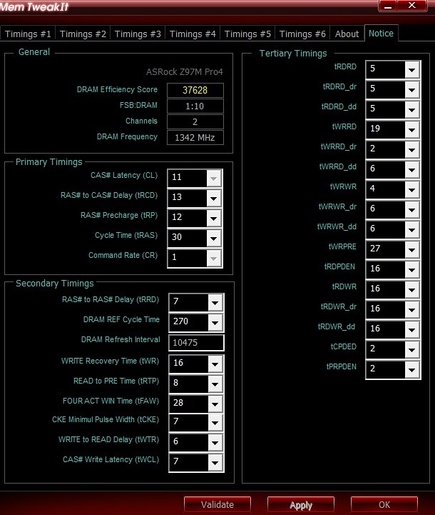

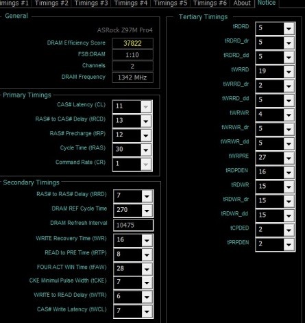

    RDWR, RDWRDR, RDWRDD all were at 15 now 16 and WRRDDD, WRWRDR, WRWRDD all were on 5 now 6. I have never been able to get the ASRock Timing Configurator to work right. MemTweakIt works though.

    A screenshot of ASRock Timing Configurator and Aida Memory Benchmark would be helpful. Tightening which tertiary timing results in the drop of bandwidth?
    Leave a comment:
