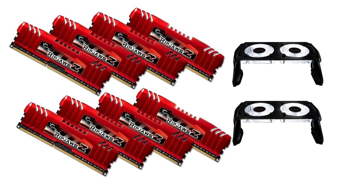

                            That is wrong. It is a 64GB kit that consists of eight 8GB modules (8x8GB). There are no Ripjaws Z SKUs that consisted of 16GB modules. You did link to the product page yourself in your other thread:
                            https://www.gskill.com/specification...-Specification
                            It both says "Capacity 64GB (8GBx8)" and has a photo of the eight modules with two memory fans (one for each of the two stacks of DIMM slots, on either side of the CPU socket).
