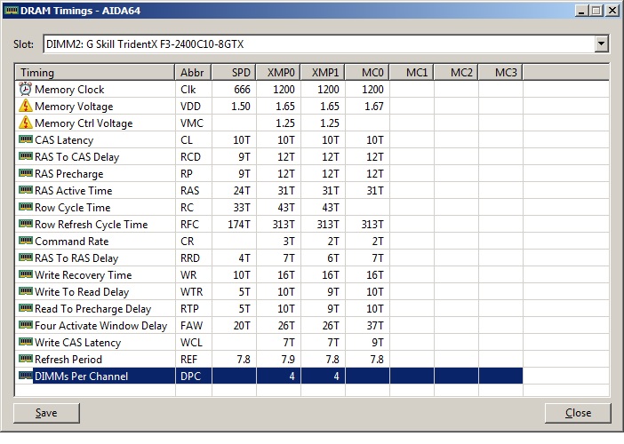

Hello G-Skill tech savy people,
Here a plee for help trying to get F3-2400C10D-16GTX (2x 8Gb 2400Mhz CL10 1.65v Tridents) sticks to work in a dual channel setup on a Asus Maximus VII Gene + i5-4690K.
I've flashed the mb's bios to the latest version (2702, 2015/05/27) and loaded default settings.
I was running 2x 8Gb 2133Mhz CL9 1.5v sticks in the same mb before trying getting the Tridents to work, and had that setup running stable on 2400Mhz 9-10-11-26 on 1.67v so the mb and cpu can run 2x8Gb 2400Mhz sticks without problems for sure.
System agent i set to 1.25v, and i tried feed the io-analog and digital settings a little extra as well, same for vccddr.
I can only get to work one of the Trident sticks at a time, the moment i put in 2 sticks the machine will keep on going in an endless loop trying to post, but never get there, and i have to remove one stick to be able to post. One stick at a time will post np, i can then adjust settings in bios and boot into windows on 2400Mhz just fine, but even on the default setting of 1333Mhz the machine will not post once i place the other stick as well.
I swapped the sticks, they both work fine as a single stick setup on 2400Mhz, and i also tried using the secondary dual channel pair of memory sockets on the mb to rule out a faulty socket maybe.
This is the 2nd set of F3-2400C10D-16GTX i am trying to get to work, both give same problem, so it's not a bad stick or set it seems.
I can't figure it out and hope i'm just overlooking something and it's not a mem+mb compatibility issue, any help is greatly appreciated!
edit: forgot to mention i tried both XMP and manual settings
