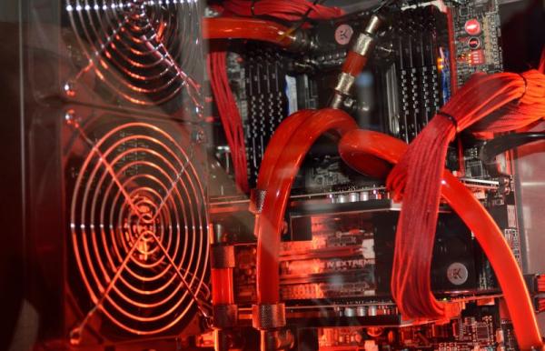

here is my current PC setup with custom watercooling:
Asus Rampage IV Exreme
G.Skill 64GB Ripjaws Z (2400 MHz)
2 x Asus GTX 680 DC2T
+ SSD`s and RAID 1 Cluster
Everything put together in a highly modified Lian LI D-8000 case.
(see attached Photo)
Unfortunately you cannot run the RAM with the Turbulence fans on it, since they just don´t fit on a Rampage IV Extreme when you have a GPU in the first PCI-E slot. By the way who has released that ram for that board
 . Ok - this is another story.
Here is my problem. I have some very strange effects when I start to overclock the RAM Modules to their XMP Profile with 2400 MHZ (10-12-12-31 CR2, VDIMM 1.65 V). The VTT Voltage is on 1.25 V. The same for VCCSA. My CPU (3930K) is overclocked to 4.8 GHZ (24/7) with 1.43V. So far pretty stable (prime95, Aida 64, memtest, Crysis 3...).
But when I run the AIDA 64 Memory Benchmark at this memory speed I receive a bandwith result of ~ 6GB/s !!!!!. After I have manually lowered the RAM frequency to 2133 MHz while keeping everything else (incl. timing) on same level as before I reach ~58 GB/s bandwith.
First I thougt it is an temperature issue. So I mounted two temperature sensors on the heatspreaders on the left and right bank. I did not want to remove the heatspreader to measure the die temperature directly. The surface temperature reaches with the standard profile (1333 MHZ, 1.5V VDIMM) round about 36 °C (idle) and 45 °C under heavy load (for 1h) with memtest. Overclocked the RAM (2400 MHZ, 1.65V VDIMM) has idle temps round about 40 °C and under stress it goes up to 60° C. I repeat this is the temperature ON the heatspreader and not the temp of the chip. Since I don´t no the exact heat transmitting capacity of the aluminum heatspreader I can only estimate the temperature delta between temps on the the heatspreader vs. real chip temps. When I assume that RAM chips should be able to resist 85° (some temp extended modules up to 95°C but with restrictions) there is an delta to the max surface temps of the heatspreder of ~25 °C. This should be enough ? Or ?
Any comments, workarounds and or help concerning the bandwith issue and my thoughts regarding the temperature situation are highly welcome.
Furthermore If anyone has found a way to mount the Turbulence fans on a RIVE board (even with modifications) I would be very happy if the one could tell me about.
