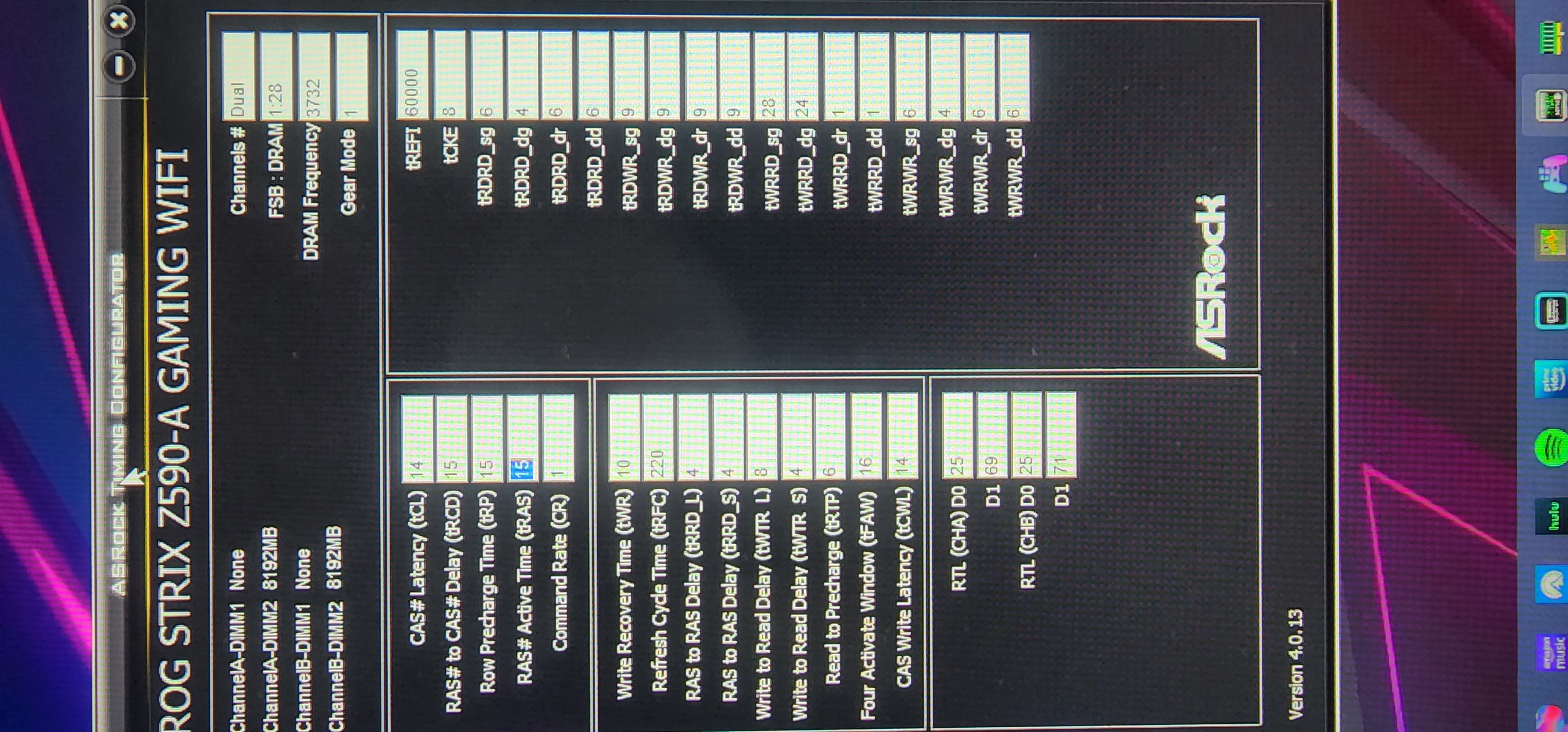

        I actually figured out my issue. Apparently the 13-14-14 primary were stable until you started changing secondary and Tertiary timings. I went back to 14-15-15-35 and was able to not only tighten everything up, but was also able to increase frequency. So this is what I got let me know what you think.
        I am not able to go any higher than 3733mhz on this particular kit. I did get 4233mhz to boot. But I had to go to Gear 2 and 2T on timings so I didn't get a real good performance increase.
          VCCSA: 1.35V
          VCCIO2: 1.30V
