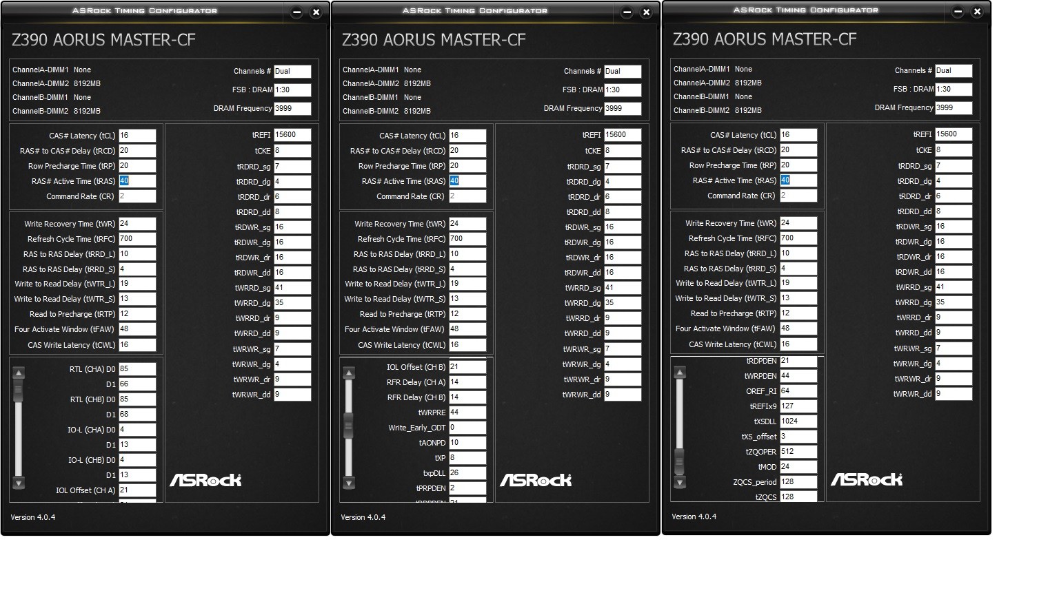

    this week I installed above mentioned two sticks in slots 2 and 4 of the Gigabyte Aorus Z390 Master.
    Never had any stability issues before, with everything on auto in the bios, which is the latest version F11n.
    Now I set most of the advised values manually from the gigabyte overclocking guide for these boards, but clocks are on stock levels.
    XMP is enabled. Memory enhancement to normal.
    Voltages are 1.25 for VCCIO and VCCSA. LLC is set to Turbo. DRAM voltage 1.4V.

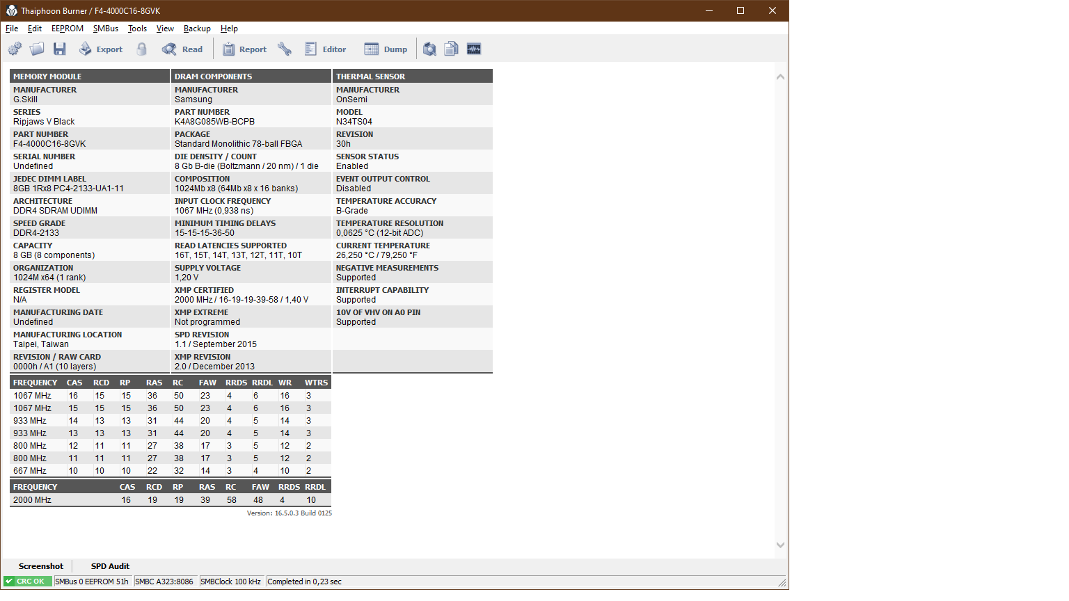

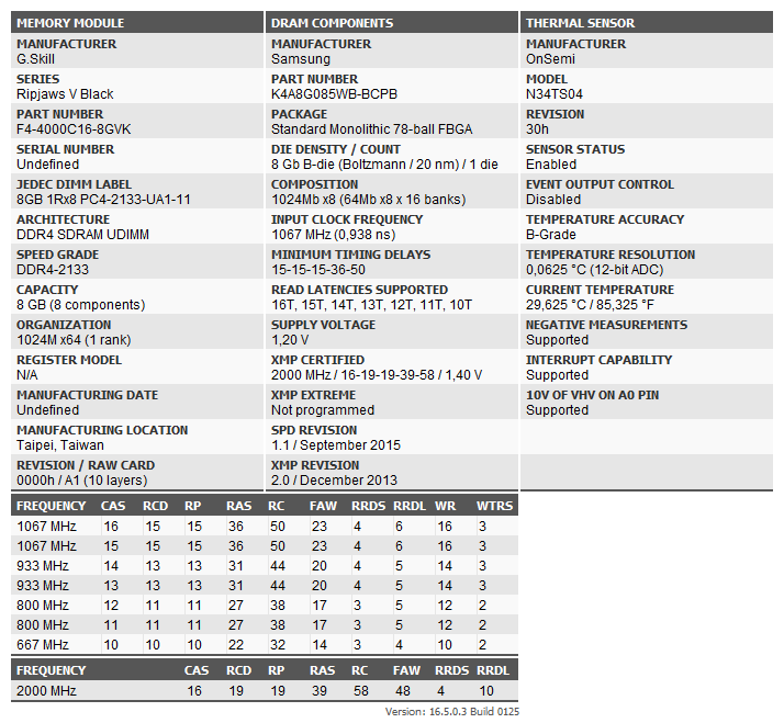

    See attached screenshots for the memory timings and readout of the RAM from Thaiphoon.
    I increased timings 2-4 due to the instructions in this guide:https://github.com/integralfx/MemTes...d#overclocking
    Even at these "stock" settings from XMP, the system is unstable in memory tests like OCCT memory SSE after a few minutes. Immediately errors from Memtest5, which I dont want to use because of missing documentation for the custom configs. Prime errors too after a short time.
    What advice can you give me, when going for stable settings at stock clocks?
    When that is established, how would you advise to move forward, tightening the RAM timings?
    And what I dont understand, why isn't there a complete liste of all the (sub-)timings for the different RAM sticks available from the manufacturer?
    If you need more information, please tell me.
    Thank you in advance

      After wasting the sunday, trying to find stable settings with "Memory Enhancement" in the bios on "Auto" or "Normal", I switched to "Relax OC".
      You can see the differences it makes in regards to the timings in the screenshots attached.
      This "Relax OC" is 1 hour stable in TestMem5 @ 1.45V VDIM (not Vcore) and 1.25V VCCIO/VCCSA, without a single error. Finally!
      I just finished 10 minutes in TestMem5 @ 1.4V Vcore and 1.2V VCCIO/VCCSA without any errors.
      The normal memory enhancement gave me very quick errors, mostly in the first 2 minutes, test 4 or 6 of the extreme config.
      I will keep testing what you asked for in regards to lowest stable voltages and get back to you again.

            Also can you make a Thaiphoon Burner screenshot?

              Thaiphoon attached.​​​​​​​ Click image for larger version
Name:	Thaiphoon @151515.png
              More than 1h stable @ 1.47V VDIMM.
              Will continue to tighten, but not increase the frequency further.

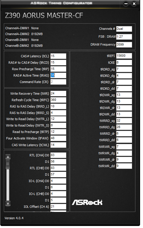

                Well it just did not work out @DDR 4000:
                Whenever I tried to lower the essential timings of tRDRD_dg and tWRWR_DG to 4, TestMem 5 produced errors.
                I might be able to try higher voltages as VCCIO&VCCSA were @ 1.22V max, but for the time being, I found a setting @ DDR 3600 which is stable after 3 runs in TestMem 5.
                See attached:
Name:	stabil ddr3600 cl151515352 memory enhancement normal trfc 360.png
                This is with XMP on and "Memory Enhancement" on normal setting.
                I will try to max out this as for now.
                If anyone has a clue, what I can do, to run these RAM sticks at their specified speed DDR4000 with low subtimings, let me know. It would be appreciated.
                For now, Pass Mark says, I am faster than the regular DDR3600 CL14 RAM from G.Skill, so that should be fine for me.
                  You don't need tRDRD_dg and tWRWR_DG at 4, lowest that is still stable. 4000 will be better in any case than 3600, probably even with those 16 subtimings.
                  I never bother with subtimings until I'm satisfied with my speed, primary timings and voltage. Subtimings are then not so hard, some just need +0.03V or so to run.

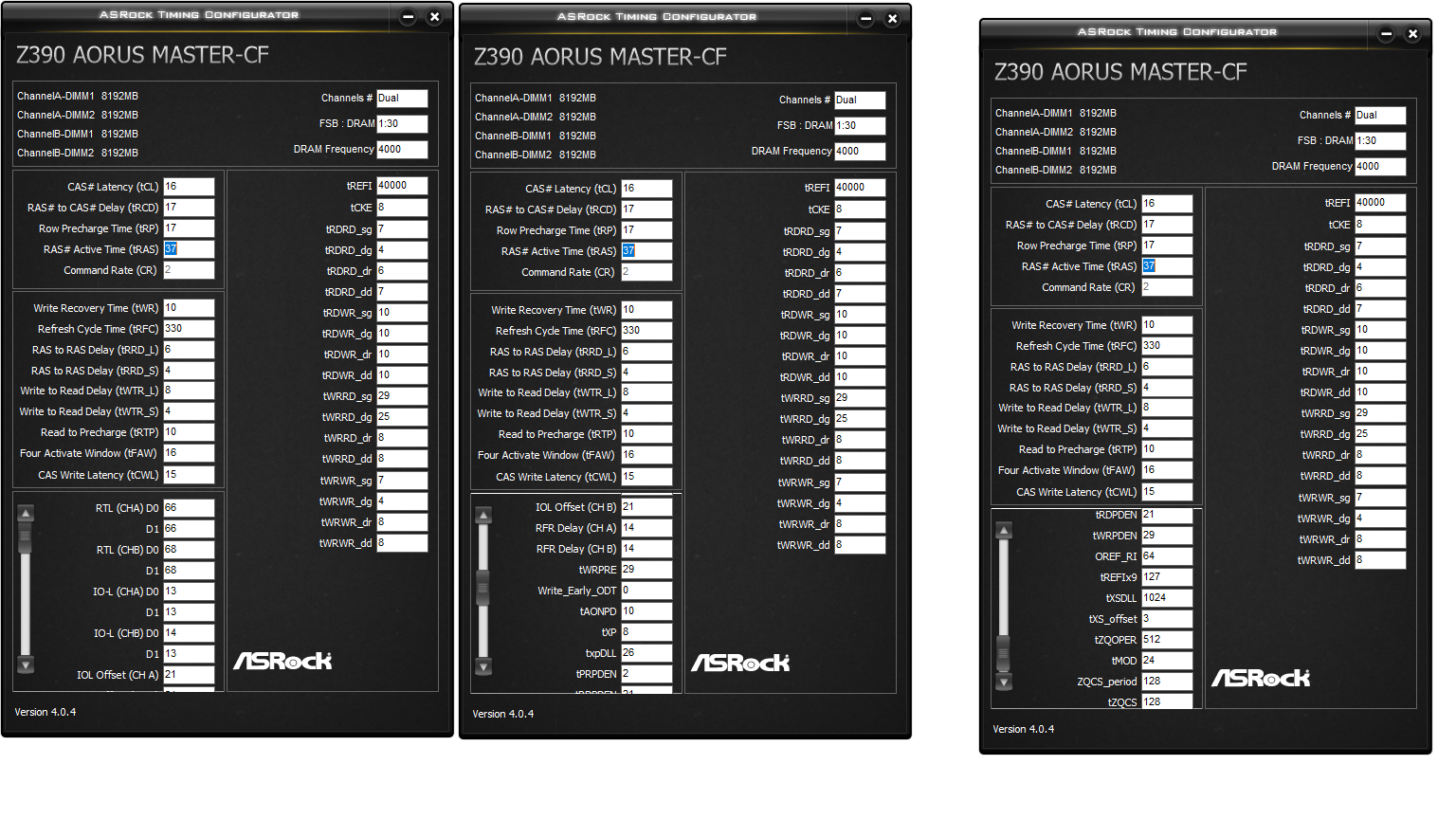

                      Okay, so I ordered another 2 sticks of the same type and tried again. This time, it was much more pleasant to adjust the RAM.
                      From 3600 CL14 I moved to 4000 CL16 with tightened timings. I could not get the RAM to stabilize above 4133 MHz, even though VCCSA tried was up to 1.32V and VCCIO to 1.25 V with VDDR @ 1.5V and timings 18-20-20-40 according to the overclocking guide mentioned in an earlier post.
                      That is why I am staying @ DDR4000 with the following timings while setting memory enhancement in the gigabyte bios at "enhanced performance".
Name:	!stabil 1h occt 4000 cl16 high performance rest so tight wie möglich.png
ID:	166684These result in 4600 points in the memory test from Passmark's Performance Test.
                      Games are smoother now with higher consistent frames, so I will stick with this, until it is time for a bigger upgrade.
