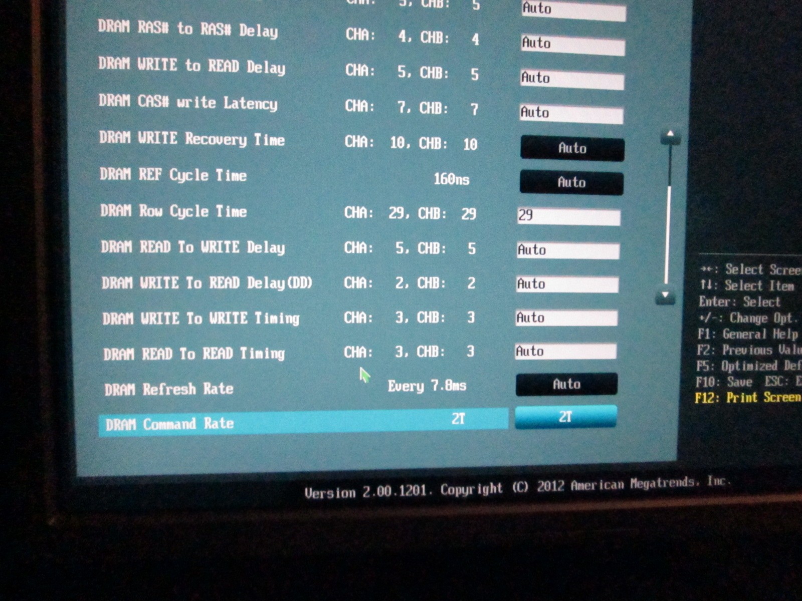

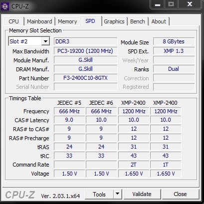

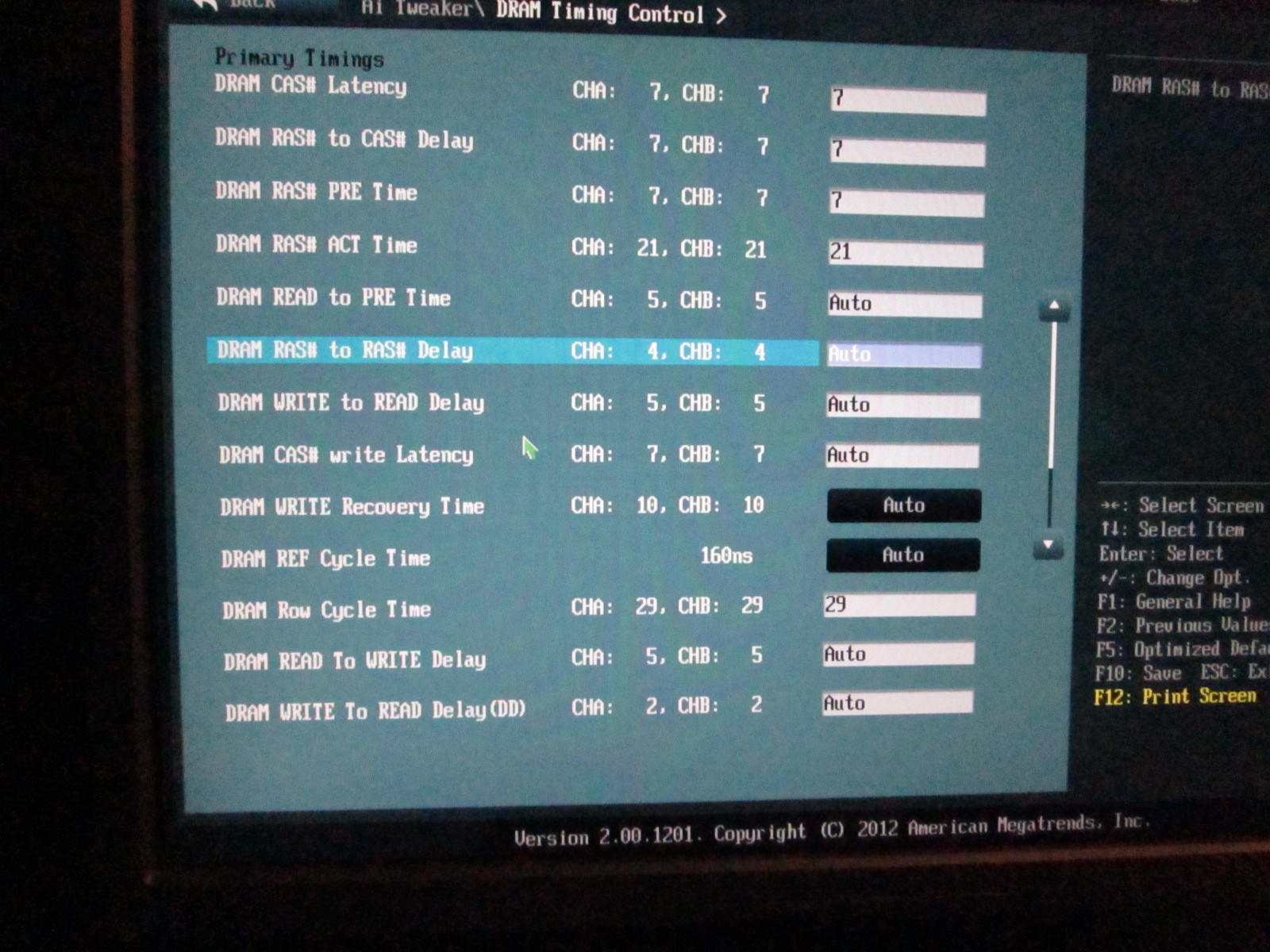

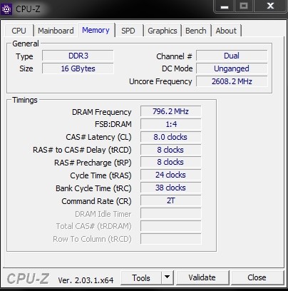

    Anything else I can do? I tried 7 7 7 21 and no dice and I dont want to oc the fsb to get 1866. the dropdown menu only has 1066 1333 1600

    Typical timings for kits like that at 1600 are 7-8-8-24. You also shouldn't have trouble running a command rate of 1T. A slight voltage bump might be required, esp if you also tighten the secondaries.
    With AM3 the reference clock can be overclocked relatively freely, which allows for higher memory frequencies. However the Thuban memory controller tends to max out between DDR3-1800/2000 (YMMV). At 1800/1866 try 8-9-9-24 1T or 7-9-9-24 1T with a bit more voltage.

      thank you for that.
      Is there any other things I can set like d row cycle time?

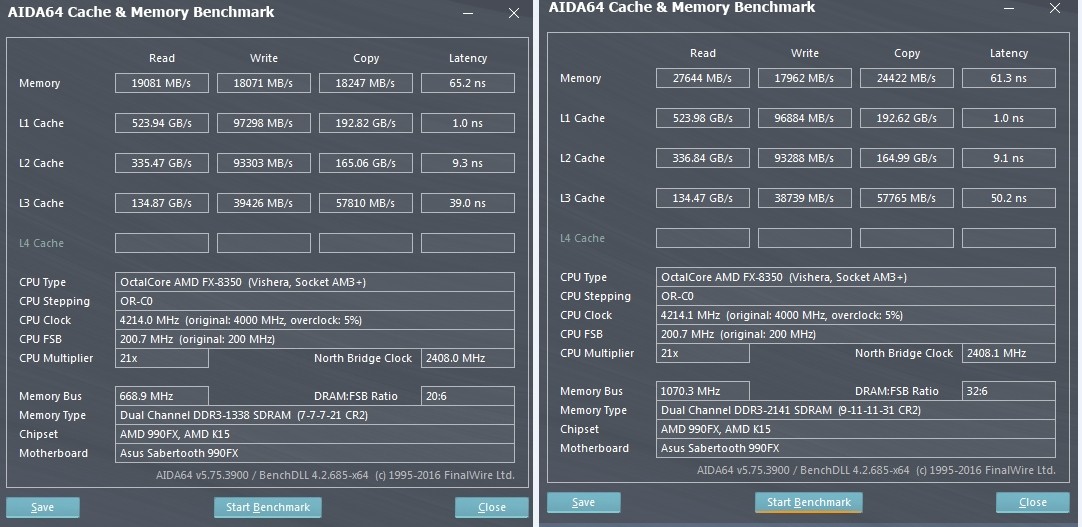

      Tjis is a screen shot of my old ripjaws ram I had at 1333.

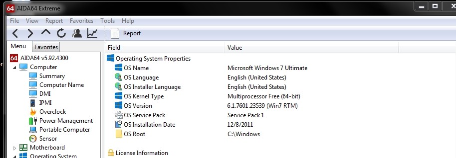

      If you are wondering, I'm still using windows 7 and I will never upgrade I dislike to m$ spying and backdoors and especially the cpu back doors

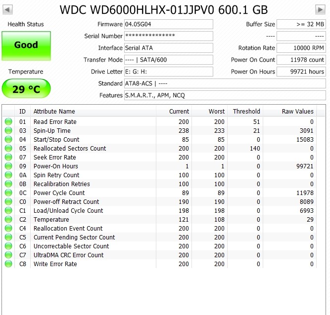

      even my velociraptor is still kicking. I run 850 pro 1tb for os and games though

        At 1600 set 7-8-8-21(24)-4(5)-4-4(5)-6(7)-10-160-29(32)-5-AUTO-AUTO-AUTO-AUTO-1T(2T).
        ( ) = backups, in case of boot issues or instabilities. Raising memory voltage instead, might also help.
        Depending upon the IC type on your modules, you might also have to up the tRFC to 300, since most 4Gbit ICs naturally require higher values and some can't handle values that low. The AMD platform does not allow values between 160 and 300, which is why 8GB modules esp at higher frequencies loose some performance vs lower density ones.

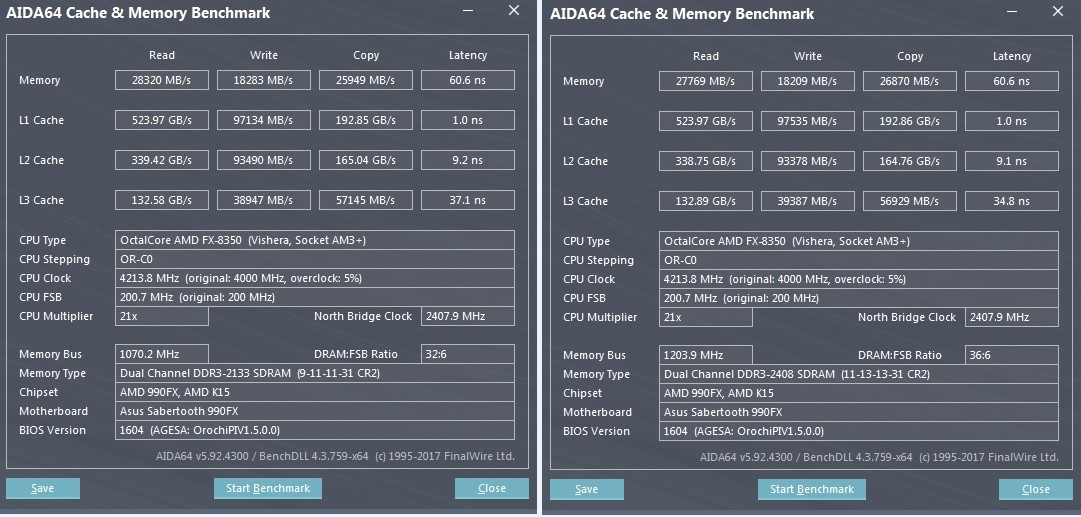

          So I put my ram back to where I been running it, 9-11-11-31 at 2133.
          I tried 11-13-13-31 at 2400 but the benchmark went down if anything.

            With proper timings and stable settings 2400 should be faster (bandwidth and latency).
              Its definatly better than the ripjaws 1333 cas 7 I had before so not a problem there
