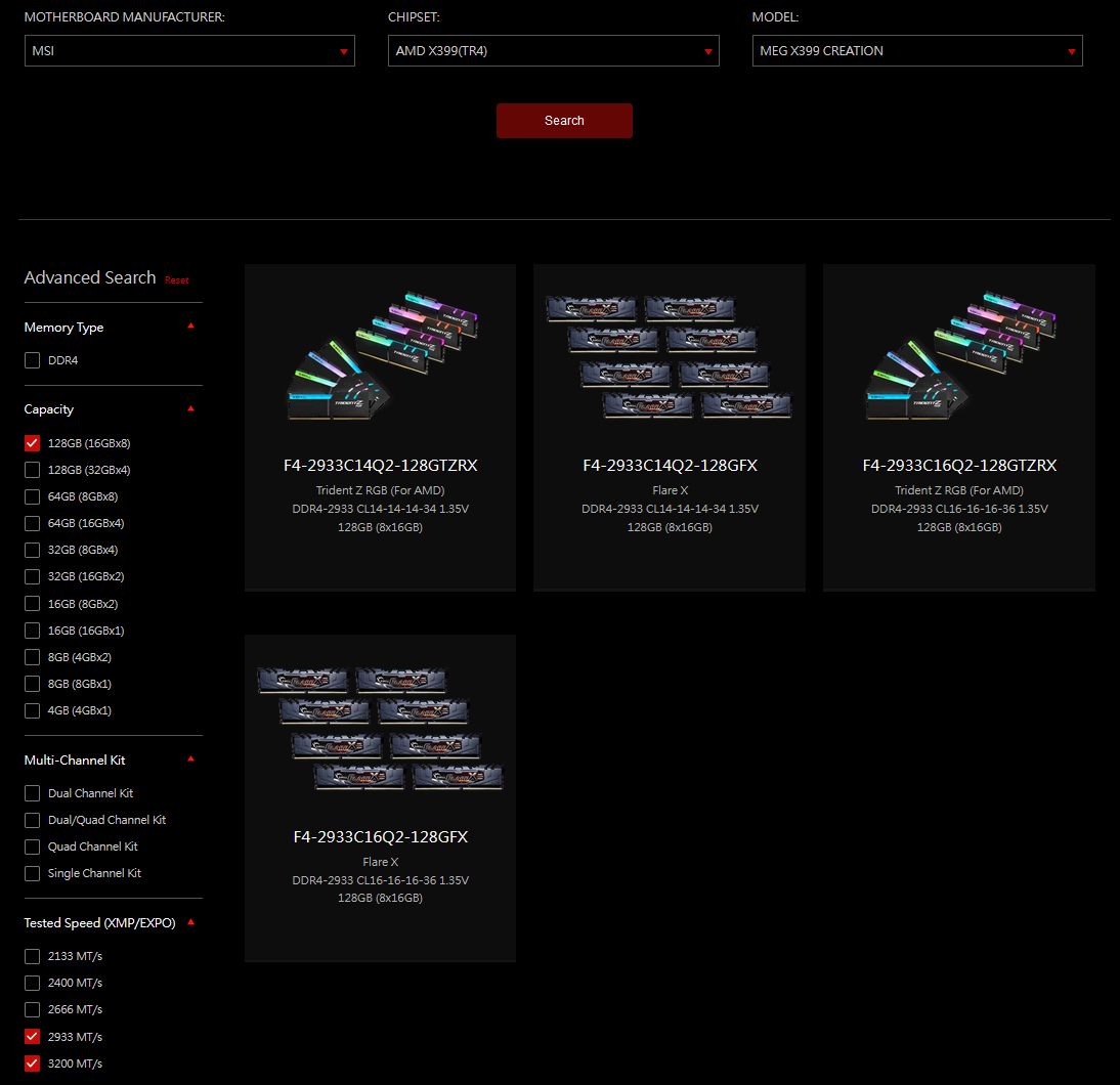

    Memory controller or motherboard might not be able to reach higher frequencies with all DIMM slots populated.Usually the RAM configurator should reflect that. It would mean, that your motherboard is probably not on the QVL of that SKU.
    My recommendation would be to make sure the BIOS is up to date and then test for the max frequency, that successfully does POST and is stable enough to boot into Windows, moving up from 2400 step by step to 2933. If the system is used for anything critical, make sure to properly test stability afterwards.

      So you meant to say that it is still possible to reach 2933 or even 3200 if I update my BIOS even if the part is not on the QVL? Thanks for the reply.
        From the results of the compatibility testing 3200 probably isn't, but up to 2933 might be possible.

        The only way to find out, is to test it with your specific hardware.
        With unqualified configurations like that, the limitations can stem from different causes. If it is just the memory training failing with the XMP @ 3200 and all slots populated, you might still be able to get there with a proper manual overclock. While that can be very daunting and lengthy process with 128GB in itself, ultimately you could also find out, that it actually was a hardware limitation of the motherboard instead.

          Thanks again for these info. I actually checked the G.Skill configuration but couldn't find my exact mobo model in the list. Seeing your screenshot, It seems that I might've just overlooked it.
          I was able to hit 3000Mhz by adjusting the DRAM Frequency, unfortunately, as you've said, there's a limitation with the MOBO. I was able to confirm this by checking with my mobo's QVL not the other way around. Thanks again for the help, I guess this is sufficient seeing that 3000Mhz is not that far to 3200.
