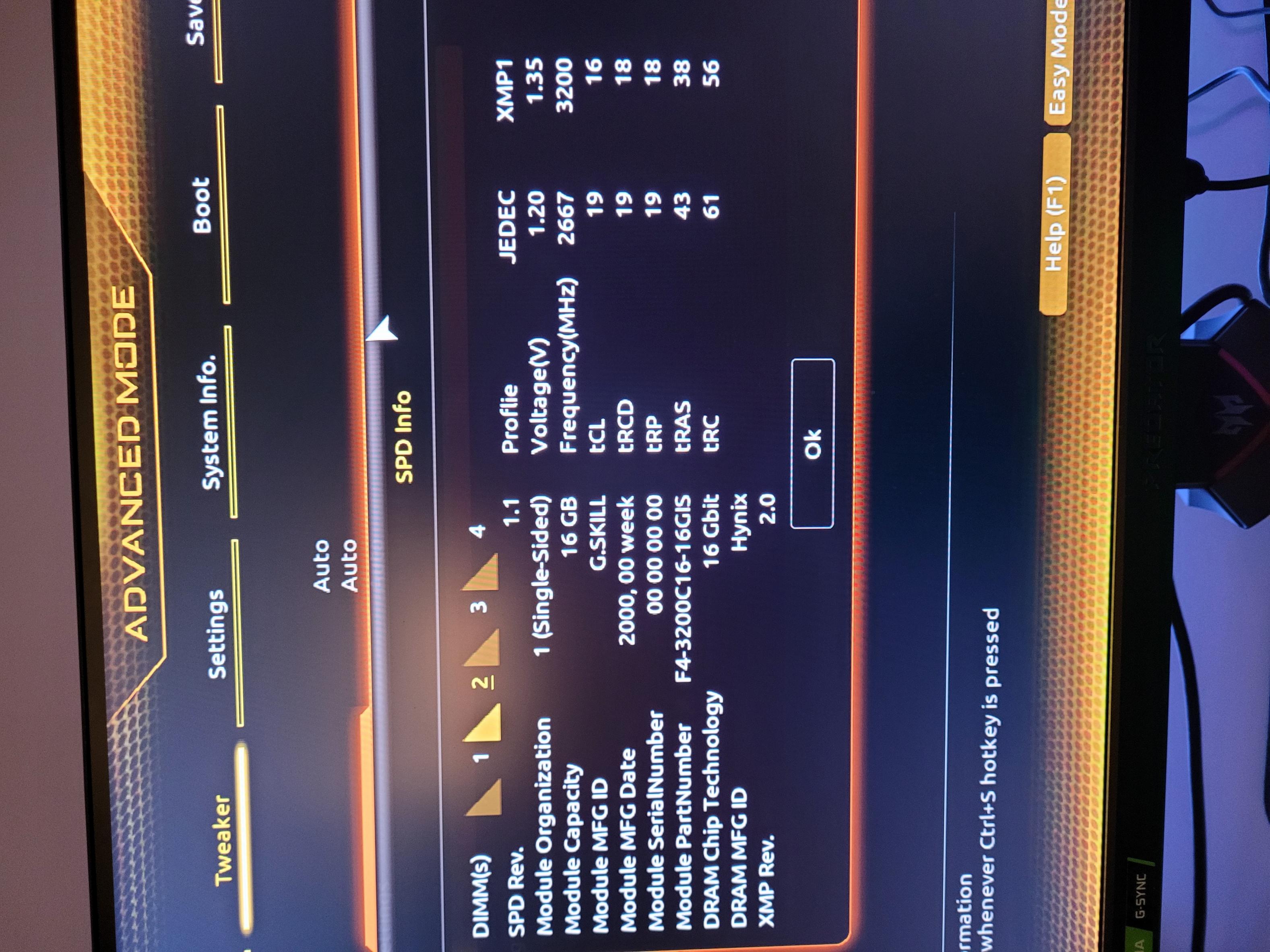

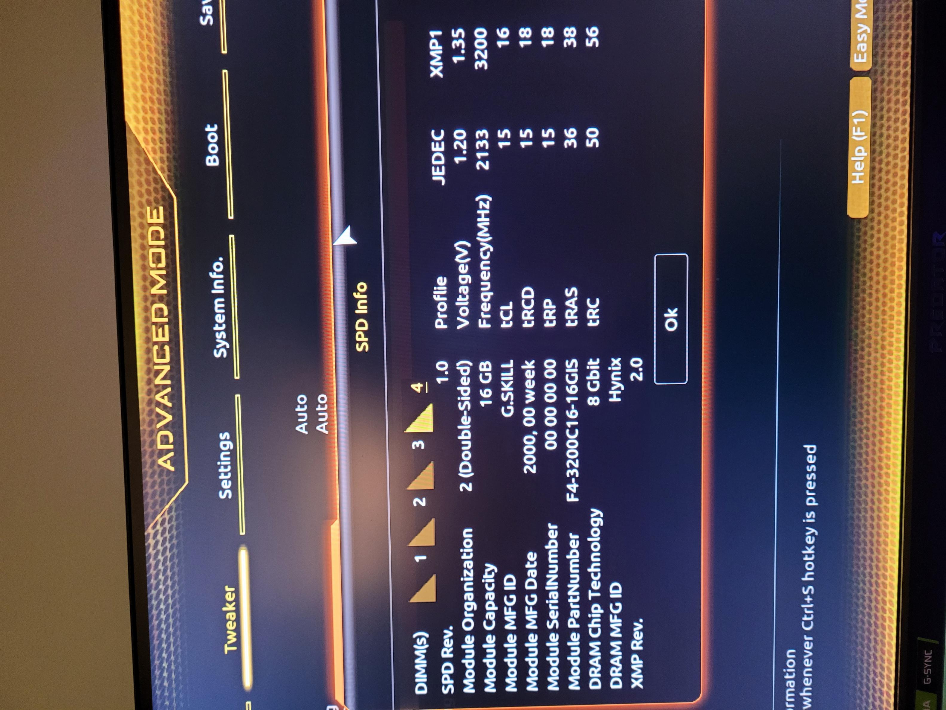

    When i look in BIOS, the JEDEC timings, module organizations, Single sided vs Double sided, SPD rev 1.0 vs 1.1, 8 vs 16Bit are all different between the sticks. Could this be causing the problems? Both sticks are F4-3200C-16S-16GIS.
    It is possible since they are not a matched set. Send them in for RMA to see if replacements can work better together.

          When i first got PC and it was crashing, i brought it back to shop and they told me they swapped out the RAM and CPU. Turns out this past weekend when i narrowed it down to RAM and they had a closer look, they only swapped one of the sticks. They discovered that even though it had the same part number, the original was "single sided/bank" and the one they swapped in was "double sided/banked", which is where you see the different timings and frequencies. So they swapped out the one that they swapped out the original for. I hope that made sense but basically i have one stick from the original build, and another new one now that is identical to the original stick.
