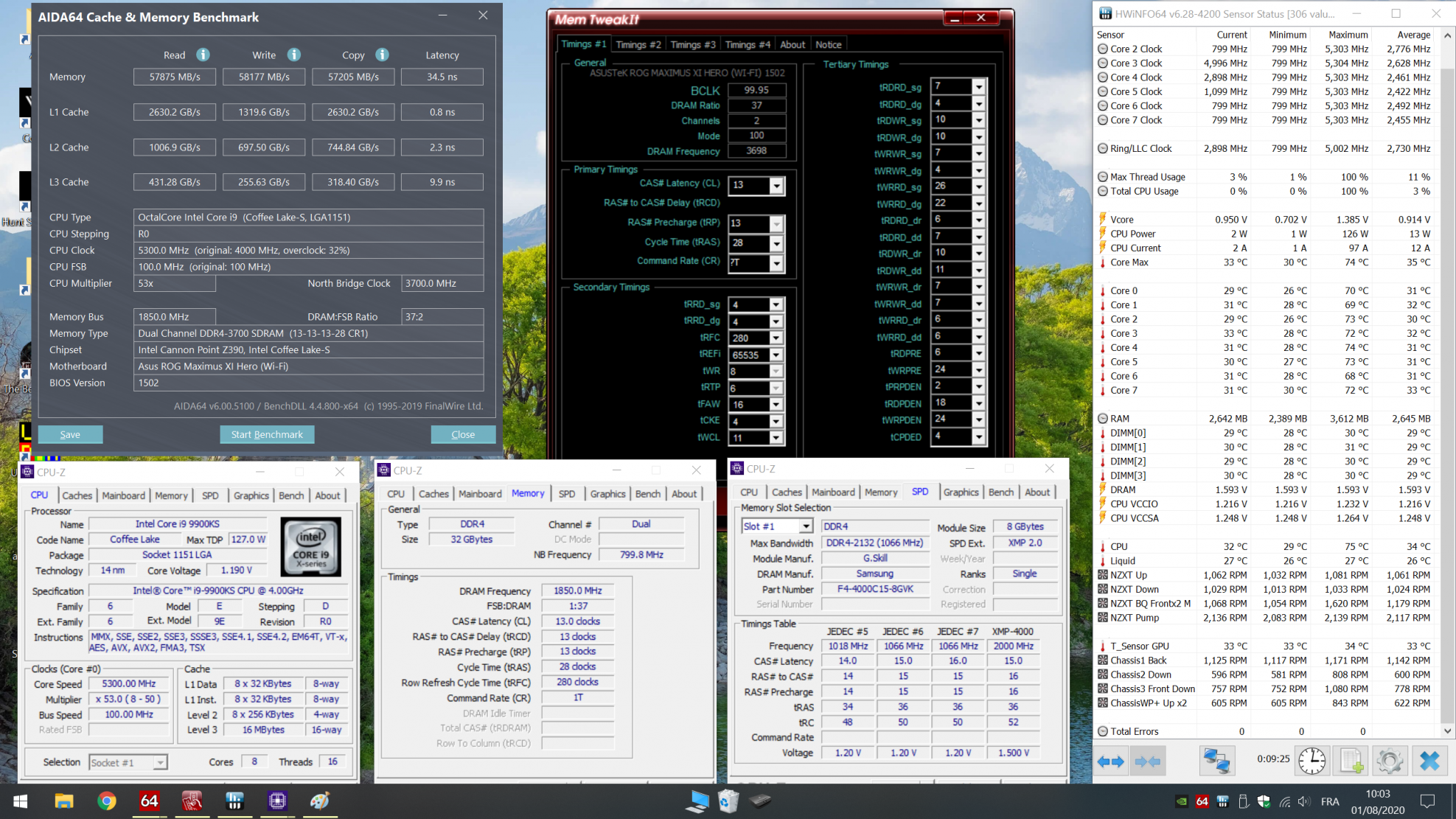

    Getting some solid results out of my new kit, so far going the 4x route is definitely a bit easier than my 2x2x3200C14 kits. I think the tighter binning on the 4000c15 definite holds as I am running a tight config with 15 15 15 35 and still tightening at 1.55vdimm 1.15io and 1.2 sa. RTLs have been manually locked in at 59 61 with a 15 offset. I've yet to tune the IOLs but I should be able to turn mode 2 maximus tweak on.

        They can do 3700 13-13-28 (nice latency for 32GB 4x8):
        Click image for larger version  Name:	3700 cl13 34.5ns.png Views:	0 Size:	1.75 MB ID:	165046

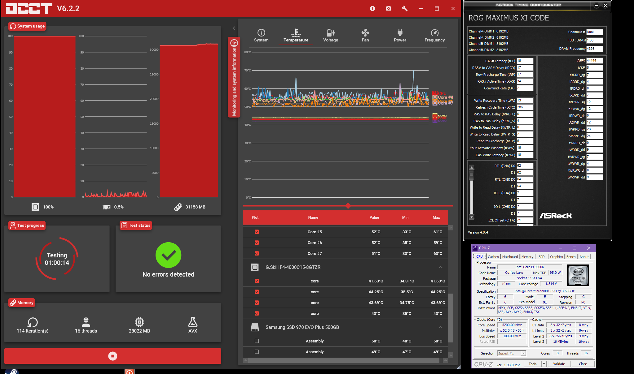

          I will add an AIDA and timings page in an imgur album. 4600 posted and worked in windows but was not TM5 stable as expected. 4500 and 4400 seemed promising but these are at higher CL than I want the kit. Will do CL 17 up to 4400 but I have the tightening down at 4200 16 17 17 34 is gsat stable.
          I have tinycore and stressapptest working so its pretty much a memtestx86 replacement. some more info here and I will make a more detailed post with my specs.
          Edit: added some quick screens https://imgur.com/a/c8NoQ1o

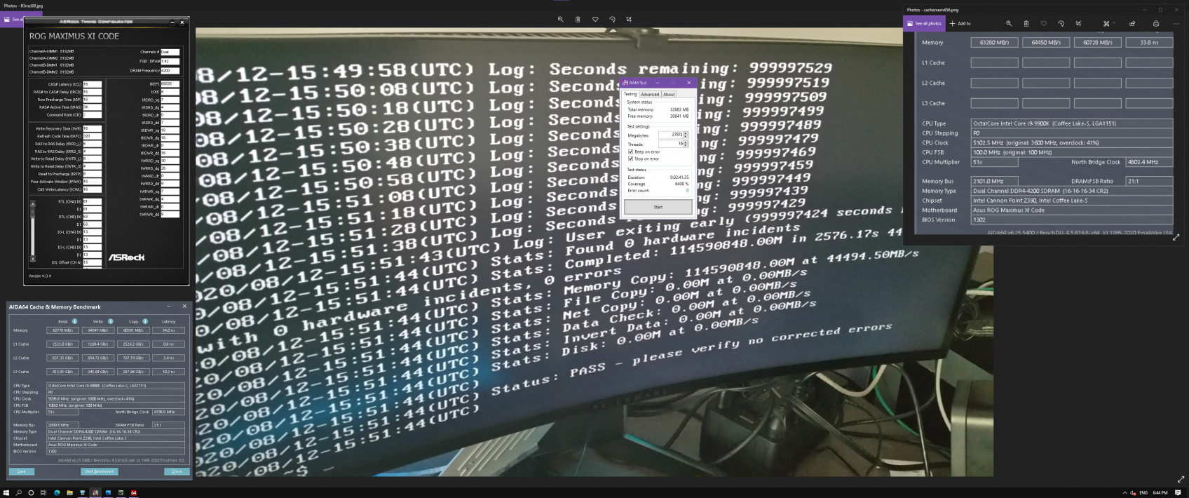

            https://valid.x86.fr/b6al1l and going to be testing this setup today with gsat https://valid.x86.fr/b083yu

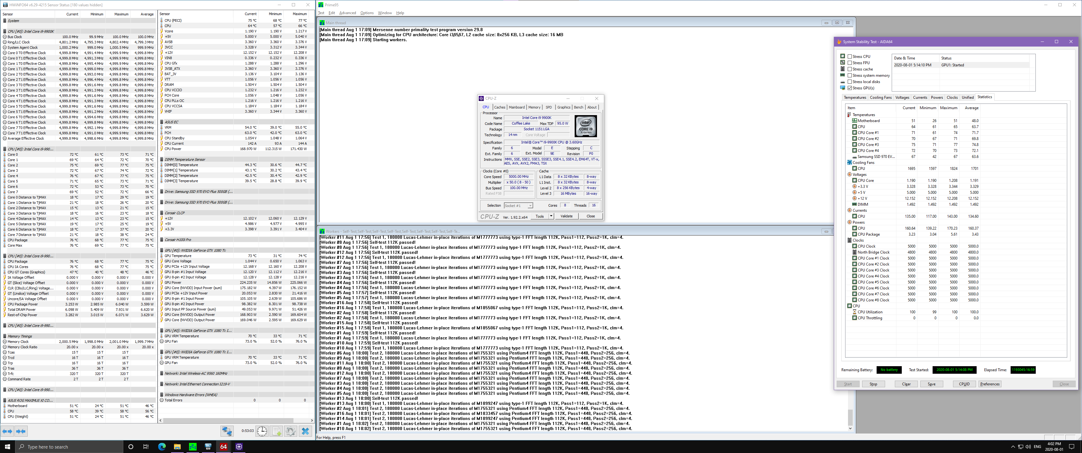

                Update: running 4200c16 stable and getting some nice latency as a bonus. Click image for larger version

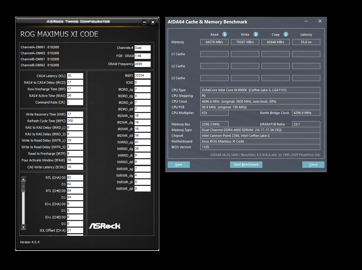

                  A little update since I have had this ram kit for 2 months now. Currently running 4400 MT/s as a daily after running 4200 for the better part of the time before. Plus I think I found some consistency getting 4600 posting which is crazy for a 4 dimm z390 t top.
Name:	Screenshot 2020-09-23 202942.png
Name:	Screenshot 2020-09-23 142038.png
ID:	165331Thank you gskill for making such godlike kits.
