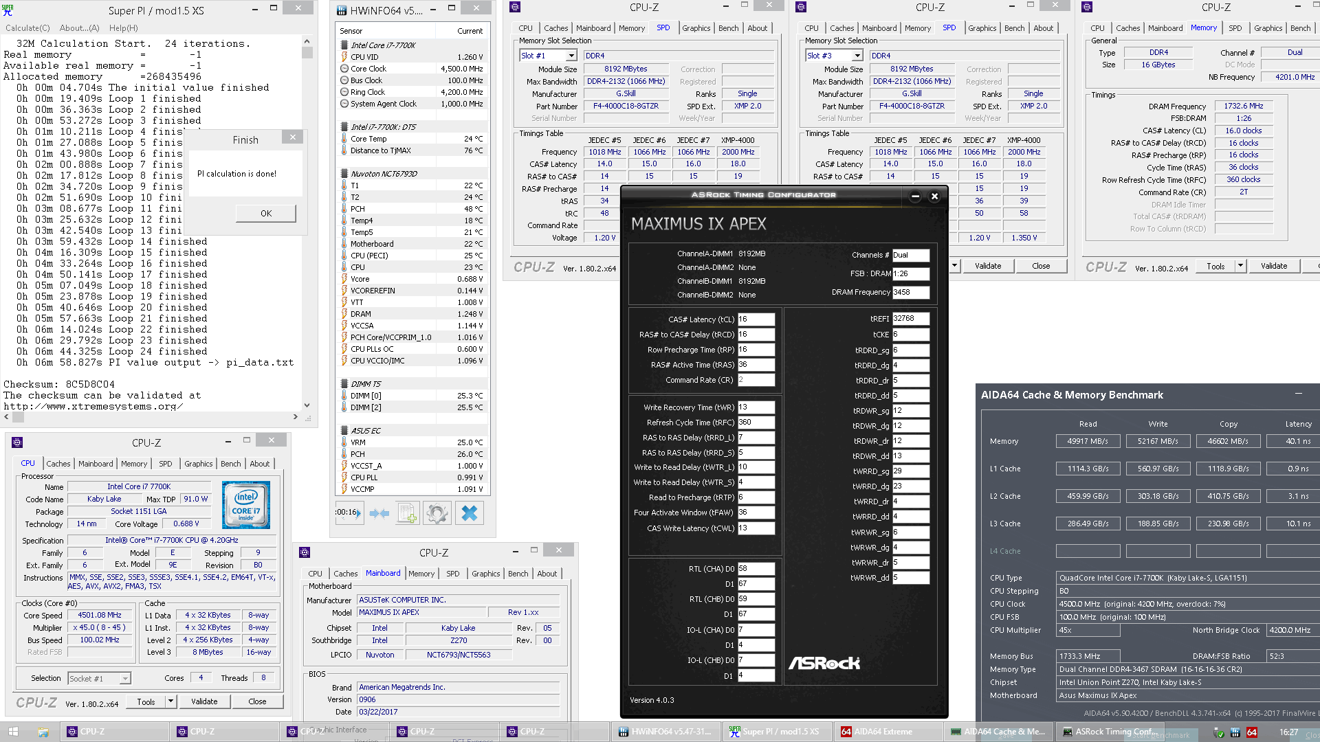

        Here is my old and pretty moderate DDR4-4000 setting, also with a 9900K @ 5GHz:

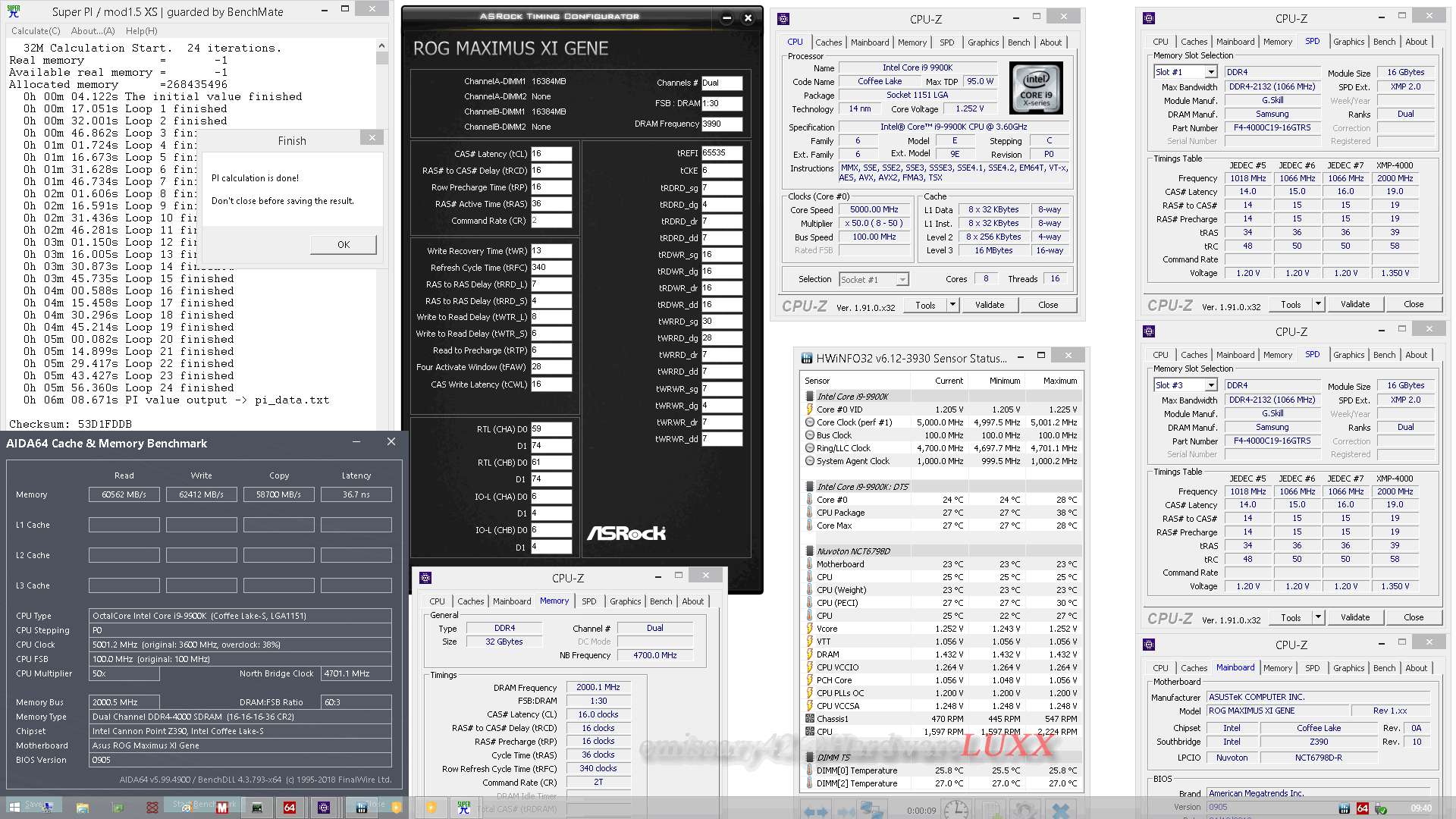

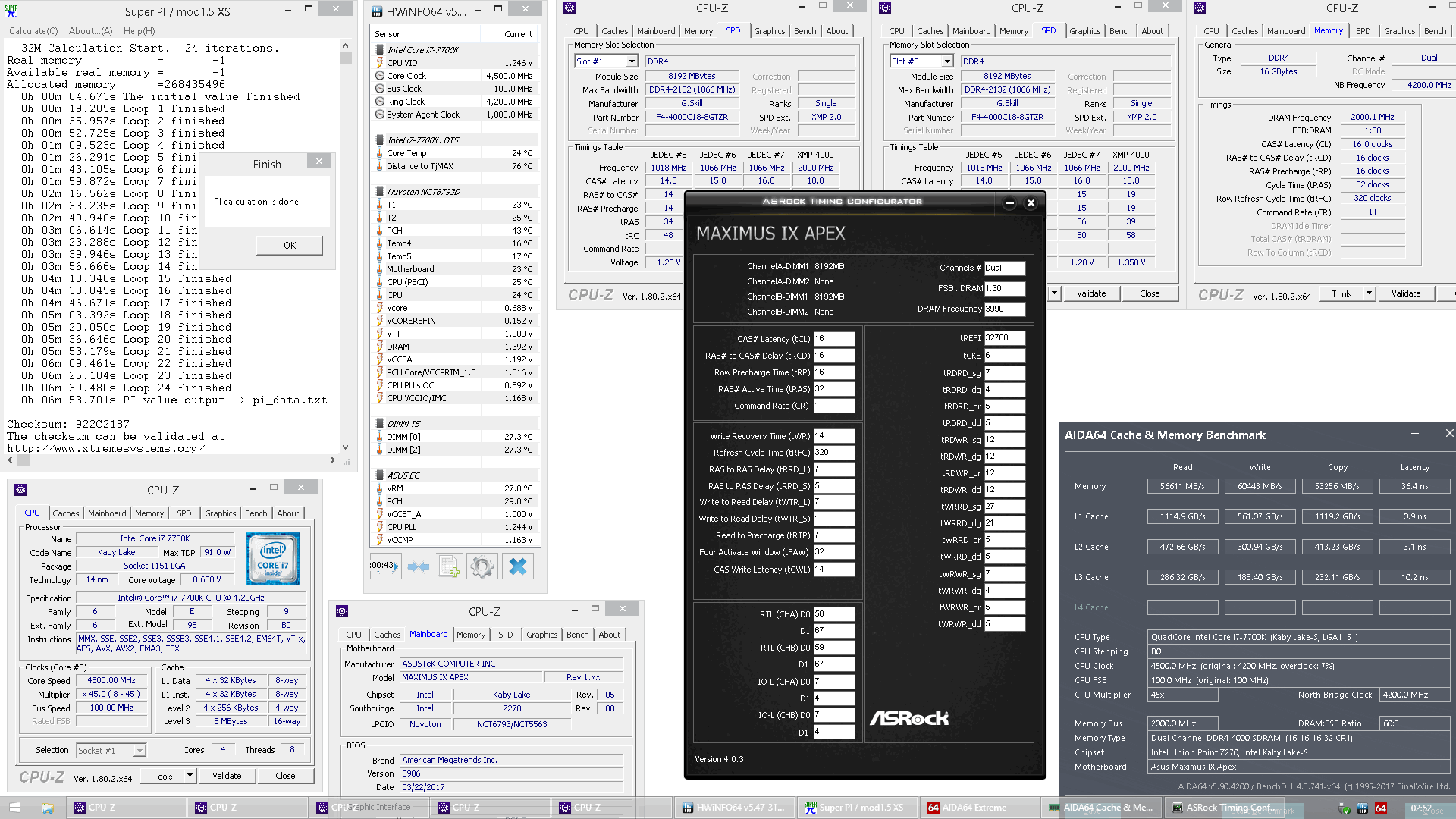

                      This is probably the closest to your XMP if have ever tested (underclocked):
                      However the same kit and system was also able to this (XMP frequency, tweaked timings):

                        Should I try those? I have 4x8 too don't know it that has a big impact
                          1:1 copying values from other systems usually does not work, even with very similar configurations.
                          You can however use these (or others) as a rough guideline and step by step work your way towards them.
                          Edit: Just leave the command rate at 2T.
