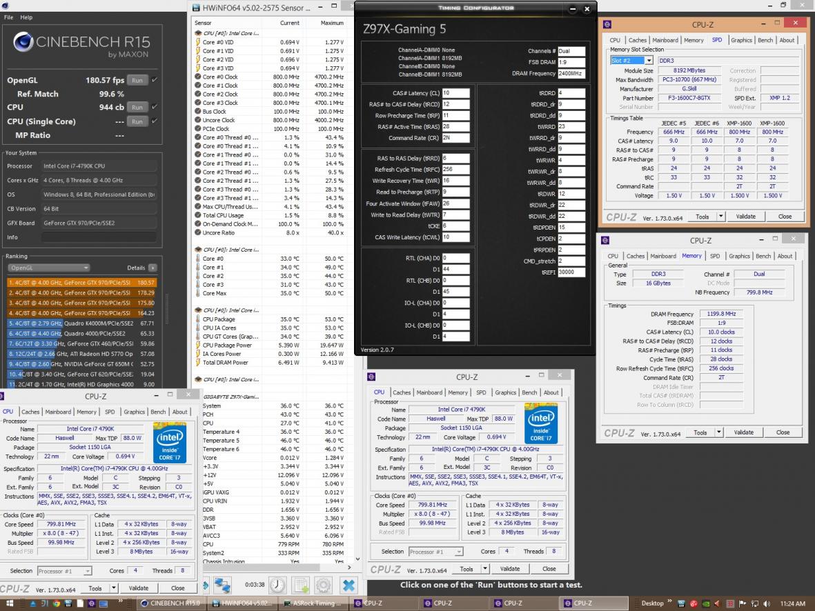

                Below is where I'm at right now.
                I tried lowering tRAS, and tRFC, but the timings didn't stick. There might still be something on Auto that is computing these as I recall some of these have a recommended formula.
                I got a slight bump in Cinebench, and I'll run some stability tests, but so far it is promising.

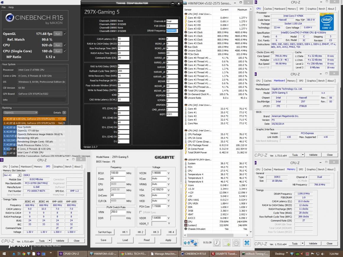

                  Looks pretty good!
                    DRAM voltage at 1.64 (per BIOS setting) but the BIOS voltage readout was indicating 1.66.
                    SystemAgent Offset increased to 200Mv.
                    another bump up on Cinebench overall.
                    I think it is good enough for now.
                    Thanks again.

                      Do you have a proper cinebench screenshot with the relevant CPU-Z tabs?
                      There is still lots of room to tighten the subtimings.
                        Apologies for not understanding what you are asking for.
                        The Cinebench I have doesn't have much to show, and CPU-Z has only a few timings.

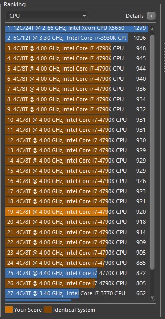

                          Well it is hard to put your cinebench scores into perspective, if you don't give us that actual scores and at what cpu clock you were testing. I don't bench cinebench a lot, but i have a few scores to compare it with. A 4790K at 4.8GHz with G.SKILL TridentX F3-2400C9D-8GTXD at XMP settings gave me around 986cb/193cb in CB15.
                            Cinebench comments were relative, and mostly referencing improvements on the CPU side measurements.
                            I lowered CPU clock to 4.6 Ghz to get voltage down. and the best CPU score at 4.6 Ghz was 931
                            CPU @4.7Ghz was not stable under 1.33V which is higher than I want to run
                            Temps are OK with the Cryorig R1 ultimate even at 1.33V.

                              I set tREFI to 30,000.
                              Also increased CPU to 4.7Ghz and increased VRIN or VCCIN to 1.95 in BIOS, but the measured VRIN is 1.908. Not sure which to believe but it is within the OC limits from what I've read.
                              4.7Ghz is stable (so far) in everything except Prime95. I've read much debate about P95 and Devils' Canyon OC and I think I'll try 4.7 for a while.
