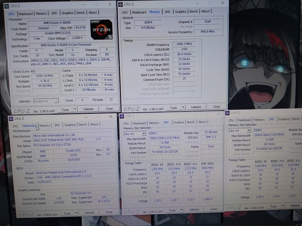

        If you don't mind manual BIOS adjustment then you can go with the DDR4-4000 kit. If you prefer using DOCP only, then DDR4-3600 kit is best.
          setup bios manualt,not use xmp ,set mem to 2T, It's my boy's pc and he does not want any overclock as the need is not there and he wants a quiet pcClick image for larger version  Name:	64GB G.Skill TridentZ RGB DDR4 4000Mhz 2x32GB (F4-4000C18D-64GTZR) on AMD 5600x.jpg Views:	0 Size:	306.1 KB ID:	168252
