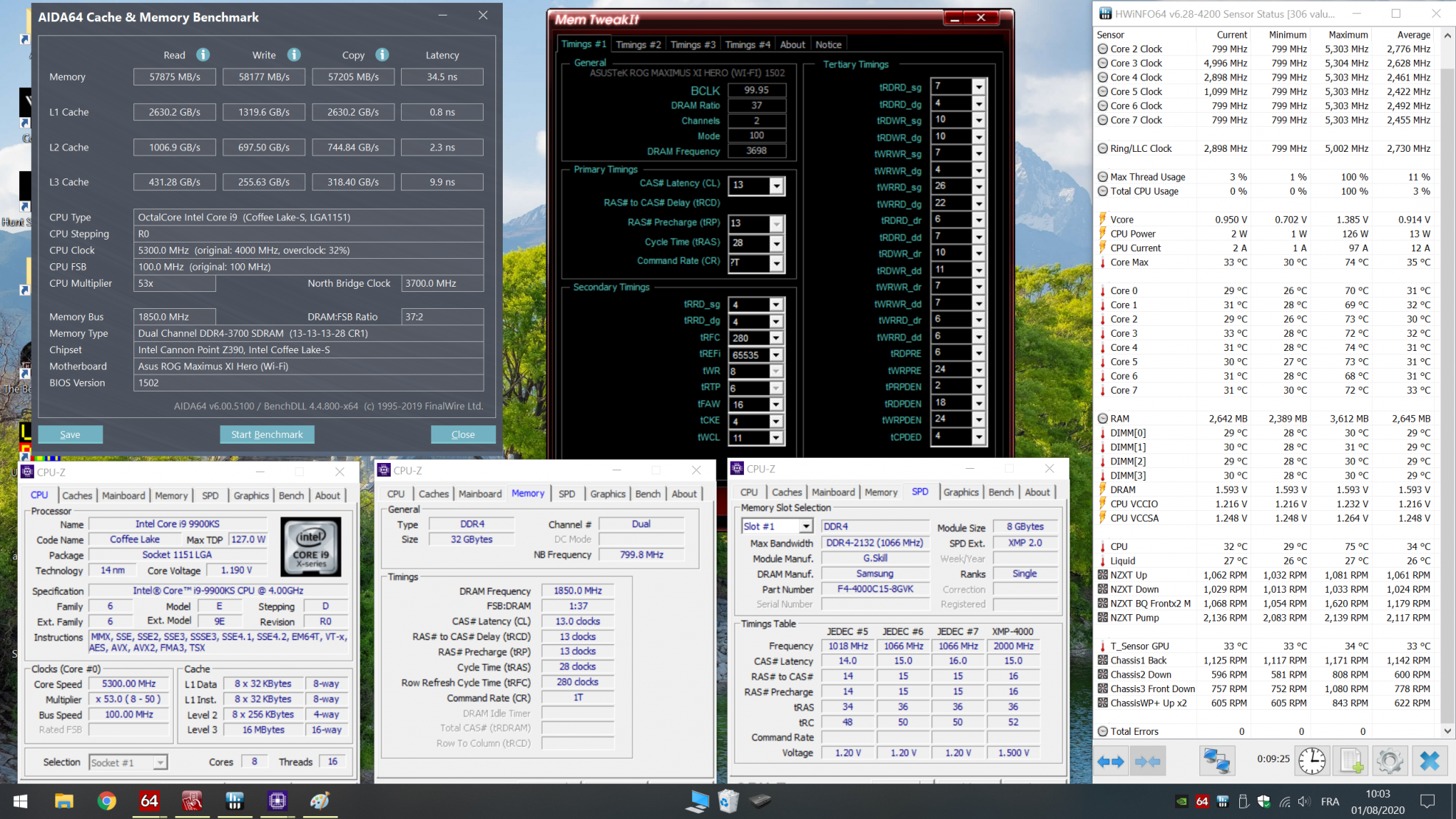

    Hello everyone!
    First, I really appreciate G.Skill brand because they provide the most extreme performance memories!
    But, summer is coming in my country, and temperatures are rising (30°c).
    And I am facing memory errors on XMP setting with my new DDR4 kit: 4000MHz CL15-16-16-36 1.50V 2x8GB (Ripjaws V).
    These errors always appear when modules reach 58°c.
    I tested at CL16 (16-16-16-36) and no more errors, even as high as 63°c (can't go higher).
    So my question is simple: what is the max safe temperature to run XMP without any errors?
    Asking it another way: what maximum temperature G.Skill use during stress tests to guarantee stability on their rated XMP settings?

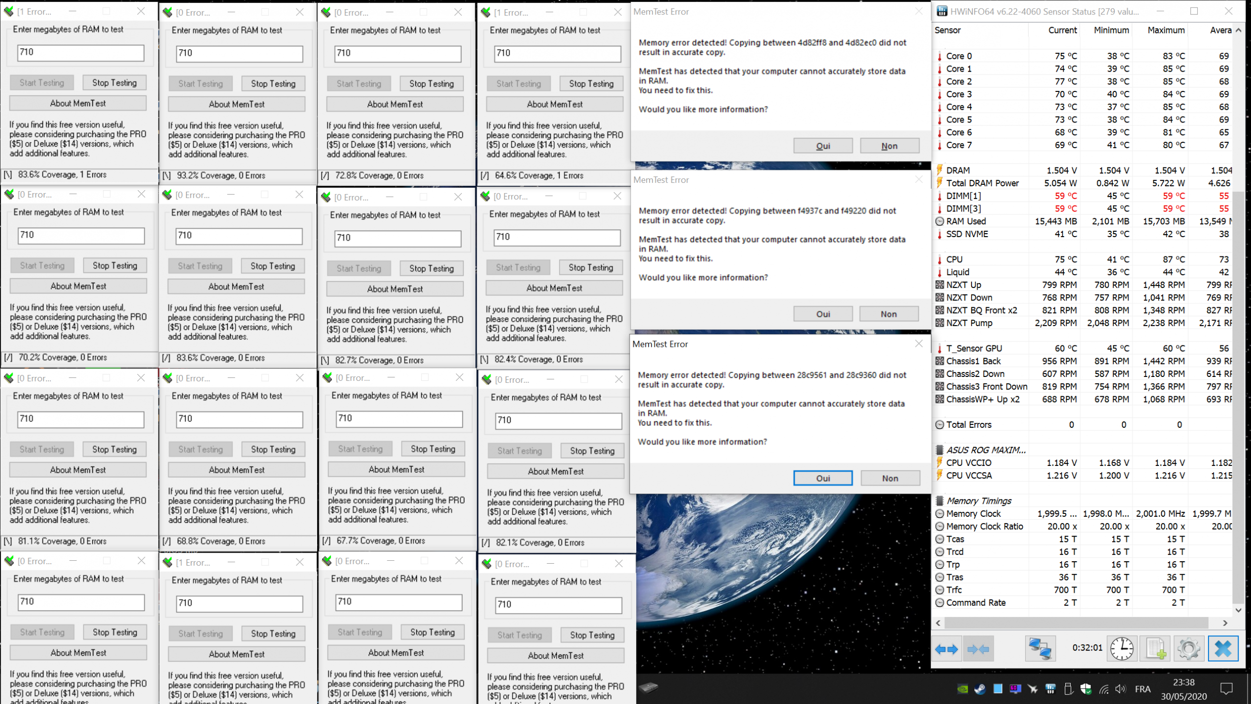

      Thank you both for your answers.
      My point was: temperature is a key point for RAM stability, but it's not mention anywhere on the spec.
      Something like this for instance XMP: 4000Mhz at 15-16-16-36 tested max 60°c.
      I mean you can kill your OS and risk to loose all your data if you reach the temperature limit of your memory, and it depends from one kit to another, and the buyer must know it.
      I have tested mine to be stable until 58° at stock XMP settings before risking to loose my system.
      Am I the only one to be concerned we are so far from JEDEC standard 85°c?
      I am not saying I will not buy a fast memory kit even not stable below 85°, I am just saying we need to know max safe temperature for each memory kit when buying, to adapt sufficient cooling and avoid loosing our data...

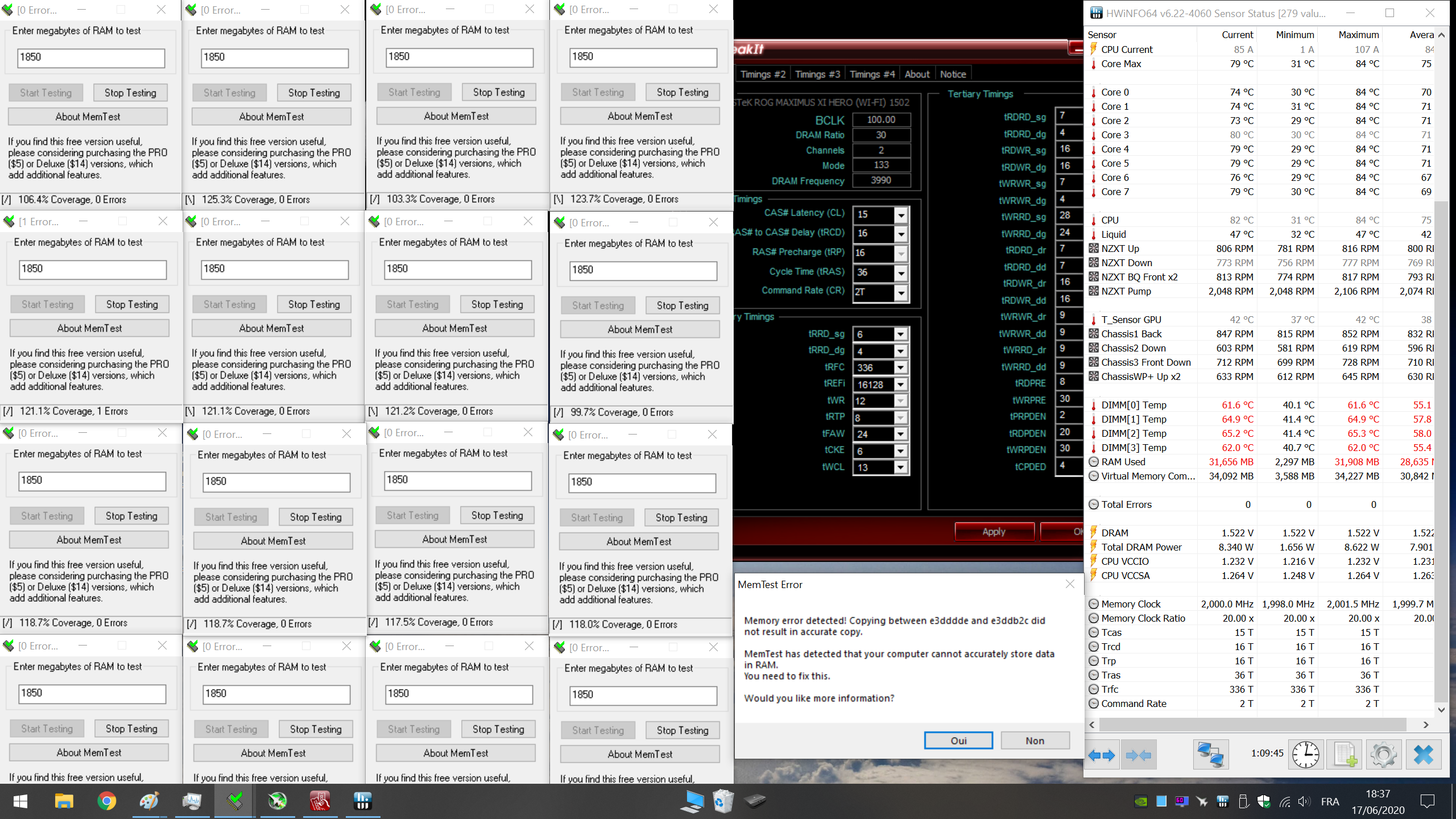

            Add the screenshot about my errors starting from 58°c at default XMP:
Name:	Stabilite defaut error 3.png
              I did some testing again, and I get rid of the errors just by increasing RAM voltage from 1.50 to 1.52v.
              No more errors, even as high as 64°c, and even with tighter secondary timings!
              It means that either voltage was not enough, either such high speed and low latency was too optimistic (4000Mhz CL15)
              My point is not to blame G.Skill, but RAM stability is critical, in order to avoid silent corruption and data loss.
              It should remain stable at least until 60°c (not mentioning Jedec 85°c)
              It's why it's very important to add the key information of max safe temperature for running XMP in the spec, such as:
              XMP1: 4000Mhz 15-16-16-36 max 55°c
              XMP2: 4000Mhz 16-16-16-36 max 60°c
              XMP3: 3800Mhz 16-16-16-36 max 65°c
              Thank you to consider my recommendation to improve your nice products even more compare to other brands...

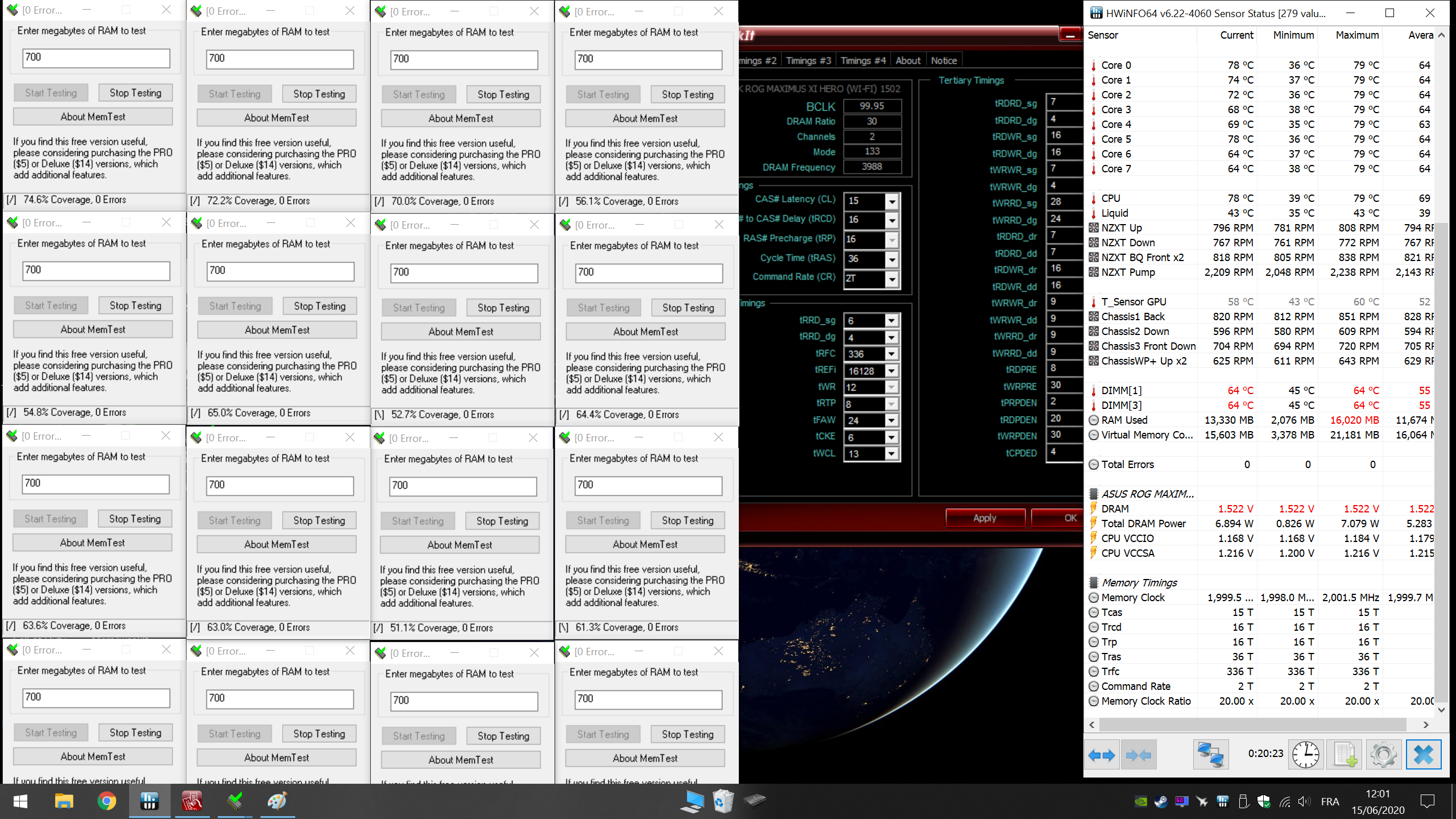

Name:	stress 4000 15-16-36 tuned 1.52v IO1.15 SA1.20 - 6XX.png
                Just to say this modules are beasts!
                So fast, even at default primary timings, and with my personal touch for secondary timings!
                Moreover, it is safe until 64°c at 1.52v!
                Good job G.Skill, I've ordered a second set of this very same modules, to have 32GB of crazy fast memory

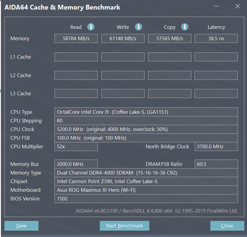

                  I received my new set of the exact same kit for a total of 32GB (4x8GB)
                  They work perfectly fine all 4 together
                  Except for the same problem of too low temperature to run default XMP which starts to throw errors above 50°c.
                  In my case, my dimms can reach 55°c during heavy gaming (big air GPU)
                  I solved this problem just by increasing a little bit the RAM voltage from 1.50 to 1.52v, which gives about 10°c more safety room until 61°c
                  Click image for larger version  Name:	stress 15-16-36 opti 1.52v 1.20-1.25 61-err mem.png Views:	0 Size:	723.9 KB ID:	164674
                  About bench, in addition to the bigger RAM size, I can see some improvements for copy bench (54->57GB/s) but a slight worse latency (37.5->38.5ns)
                  Click image for larger version  Name:	bench.png Views:	0 Size:	213.8 KB ID:	164673

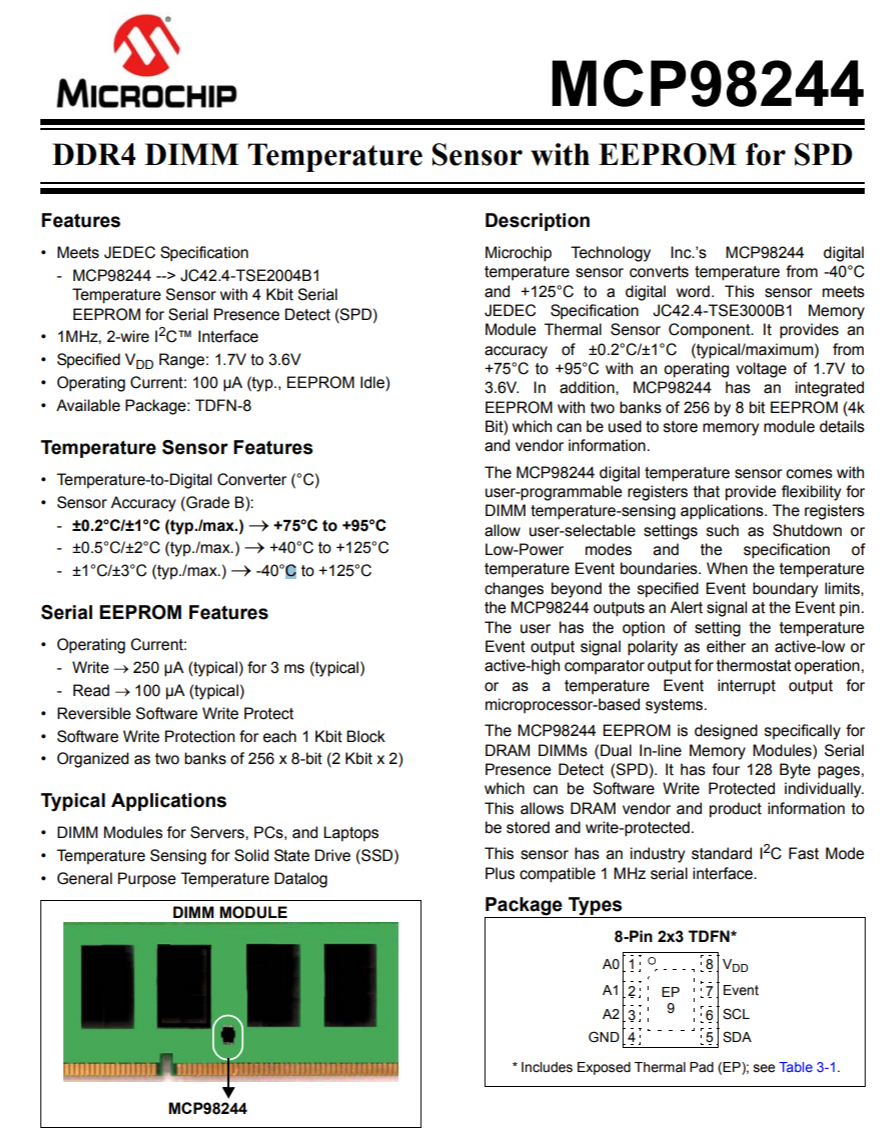

                    Just to add last information about my topic subject of RAM temperature, and as said previously by G.SKILL Administrator, the thermal sensor (which is located somewhere on the PCB), is not giving the exact temperature inside the memory chip, which should be higher. But how much higher? Only the maker know, because it depends on its exact location.
                    I found some technical information below in case some people are interested in this subject.
                    Again, RAM temperature is a critical point to monitor, in order to avoid system corruption and data loss.
                    And the only tool we have at our disposal, is the report DIMM thermal sensor.
                    In my case, default XMP with 1.50v can rises rapidly above 50°c during heavy gaming, because of big air GPU and high ambiant temperature.
                    And the difference/delta is too close to the limit where my memory IC chips start throwing errors because of the degraded signal caused by higher temperature.
                    For peace of mind, I recommend people to check their own safety temperature limit, especially with 1.50v modules that can increase faster.
                    And if too close to the limit, just rise the voltage a little to have more safety room (in my case +10°c limit with 1.52v)
                    Memory binning is very interesting process, and I wonder if someone at G.Skill can provide more general information (not confidential) like a ranking of their binning chips to know for instance if my new 4000 CL15 at 1.50v is better than the old 4000 CL17 but running lower voltage 1.35v (can it get to the same CL15 just by increasing voltage to 1.50v?)
                    Because sometime, prices don't always reflect the real performance ranking...
                    Thank you G.Skill!
                    http://ww1.microchip.com/downloads/e...Doc/22327C.pdf
                    Click image for larger version  Name:	ddr4_temp_sensor.png Views:	0 Size:	610.0 KB ID:	164701

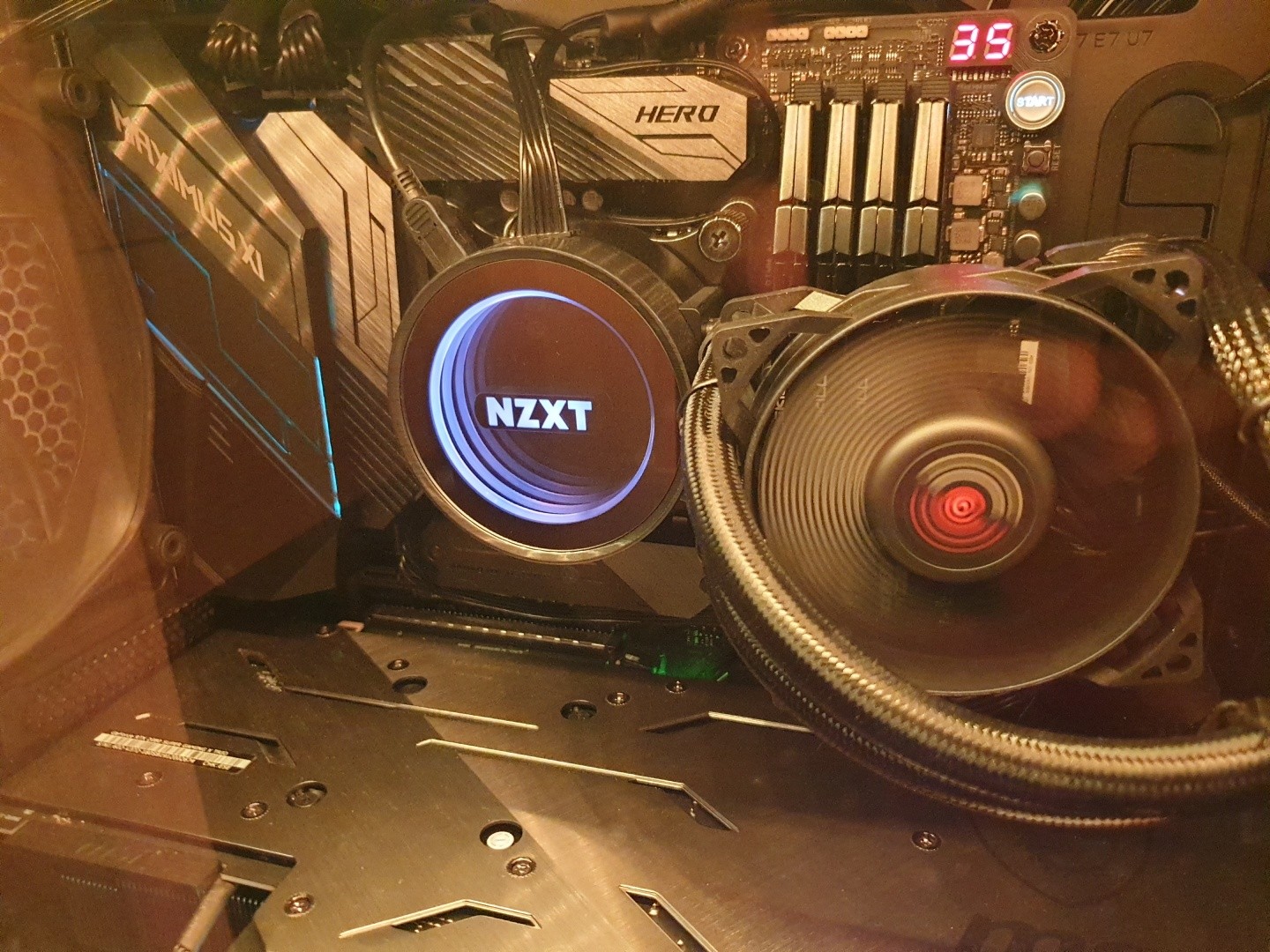

                      Some news after one month playing with these nice puppies
                      As a reminder, I've bought 2 different sets of 2x8GB 4000 CL15, and they work perfectly fine all 4 together.
                      I've fixed a little fan over them to decrease temperature about 10°c while gaming:
Name:	photo fan ram.jpg
                      Now that they are cool, it's rock stable for my daily usage at 1.50v with default primary timings and tight secondary (instead of 1.52v without fan).

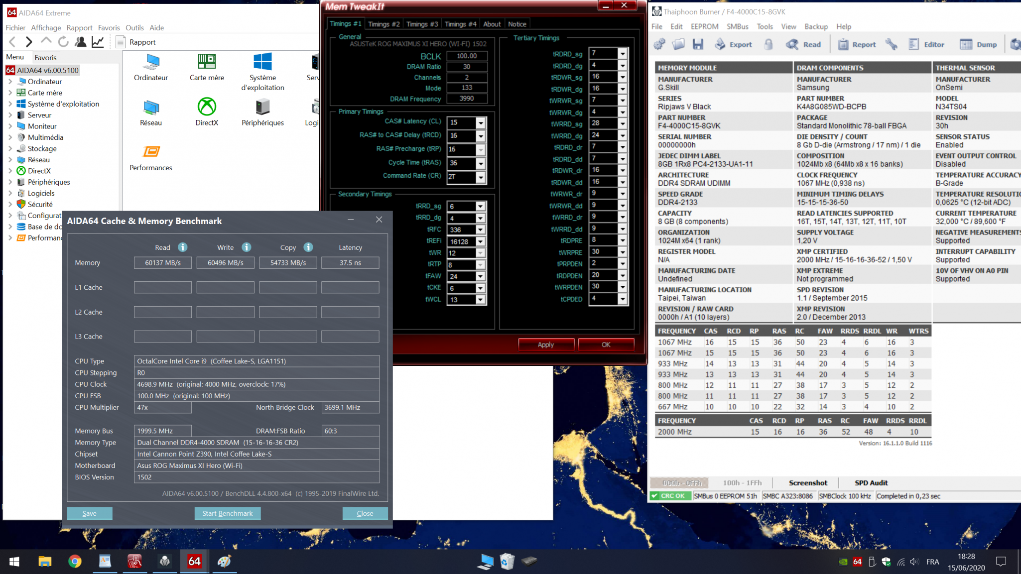

                          Hi, sorry for my late answer.
                          We have almost the same system.
                          With this kit, you must use Asus Mode 1 only, because Mode 2 sets tighter secondary and tertiary timings which don't work for higher frequencies (above 3800Mhz).
                          After playing a lot with this memory modules, I have finally found the best settings to have both performance (better than stock) and maximum stability.
                          Feel free to try it, but remember it depends on your hardware quality, especially on your CPU IMC.
                          Knowing G.Skill provide modules after testing them to be stable at some primary timings, but all other timings are choices/guesses made by the motherboard manufacturer and can be far from optimal for some memory kits (update your MB bios).
                          In case it fails to boot with below settings, try tertiary timings on auto.
                          4000 16-16-36-2 Mode 1
                          VCCIO: 1.20v
                          SA: 1.24v
                          tRRDL 6, tRRDS 4
                          tRFC 416, tRFC2 312, tRFC4 192
                          tREFI 16640, tWR 12, tRTP 8, tFAW 24
                          tWTR 8, tWTRL 8, tWTRS 4, tCKE 8, tWCL 14
                          tRDRD_sg_dg_dr_dd 6 4 6 6
                          tRDWR_sg_dg_dr_dd 16 16 16 16
                          tWRWR_sg_dg_dr_dd 7 4 7 7
                          tWRRD_sg_dg_dr_dd 28 24 7 7
                          tWRPRE 30, tRDPRE 8
                          tREFIX9 127, OREF_RI 64
                          RTL/IOL
                          73 66 66 68 68
                          4 13 13 14 13
                          21 21 14 14
                          Results in bench Aida:
                          Read: 60 252 MB/s
                          Write: 61 982 MB/s
                          Copy: 58 282 MB/s
                          Latency: 39.1 ns
                          Ram voltage stability check
                          Stressapptest (boot to Linux USB, to avoid Windows corruption)
                          1.40v first error at 450s
                          1.41v no error after one hour (RAM reached 51°c)
                          1.42v Safe
