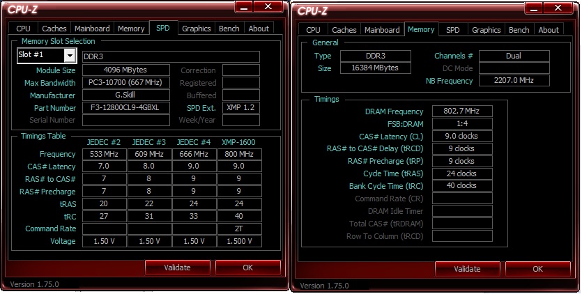

My config is close enough that i thought I'd add to this thread instead of opening another one. I have 16GB (4 sticks) of F3-12800CL9D-4GBXL, otherwise the same setup. I've really struggled to get the memory to run at full speed, but i think I finally have it. Here's the screen shots from CPUID, is this what I'm looking for? Any guidance you could provide for setting up this mobo with your memory is greatly appreciated!
Also, can you suggest an alternative memory that would provide a significant performance boost with this motherboard and cpu? I see your F3-1866C10D-16GSR, F3-2133C10D-16GSR, F3-2400C11D-16GSR, and F3-1866C9D-16GSR all available online for under $75 (as well a others in other series). Thanks.
