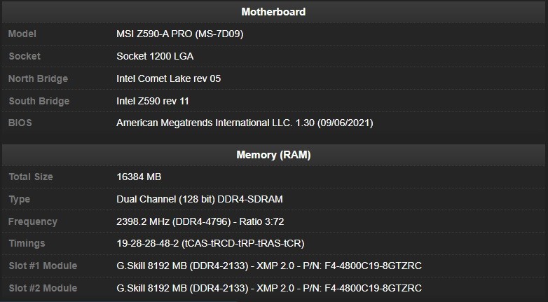

              Update :
              Able to post and boot to stable windows environment
              Using G.Skill Trident Z F4-4800C19D-16GTZRC kit
              Inserted in slots1B and 2B by using 1.543 V manually set in bios and XMP enabled, Cl 19-28-28-48.
              Have tested in benchmarks, and Gaming and data comp. Passed mem test; 0 errors.
              No over volt of bios settings for IO/SA needed. Click image for larger version
                To enable dual channel, it is required to utilize one slot of both channels A & B. That should be the case here, according to the CPU-Z output.
                If the modules actually were in 1B & 2B that would be a single channel configuration instead.
