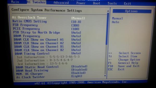

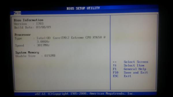

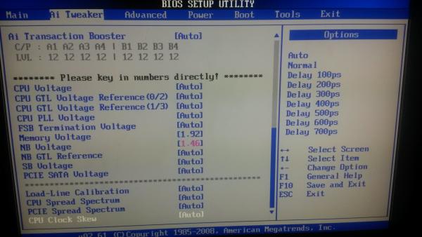

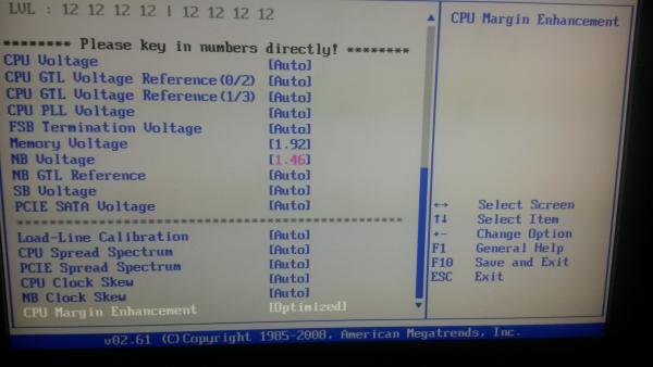

So any 2 G.Skill modules work, just not 3 or 4?
Can you send some pictures of BIOS with 2 installed?

correct, and I have tested all possible combinations.
Anything particular you want to see from my BIOS?
Will take some pictures of what I assume is relevant for you.

first batch of pictures. Hope they are readable.
