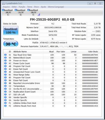

I´m having a hard time with this SSD.
First it started issue with w7 to slow and after couple minutes just stopped.
Can´t start w7 or do anything else, BIOS can find but a just can´t do anything, other OS at other HD crashes when a try format and boot cd dosent work as well.
So i started read foruns and try everything but no sucess at all.
Phoenix Original firmware update tool => Sometimes find others cant´s, whn find just crash during the process.
Boot CD.iso => Cant find. (even when BIOS did find).
Partition Magic => Same above, no sucess.
After many hours and 6 days i gave my last try, maybe this can help who is in that situation.
I just thought other OS can ignore this error, so i tryed to use OS X install...just to try exclude and format the two W7 partitions, at first can´t recognise the SSD unit, i just unplugged the power cable and reconnected and SSD appears.
1-Boot from OS X Install
2-Continue...
3-Disk Utillity
4-Select SSD
5-Format FAT32
Now is working fine and i will try install W7 again.
I get those results with CrystalDiskInfo, i´m worry about, there is a problem?
Someone can tell me if it´s everything ok?
Thx Alot
Best Regards From Brazil
Renato
